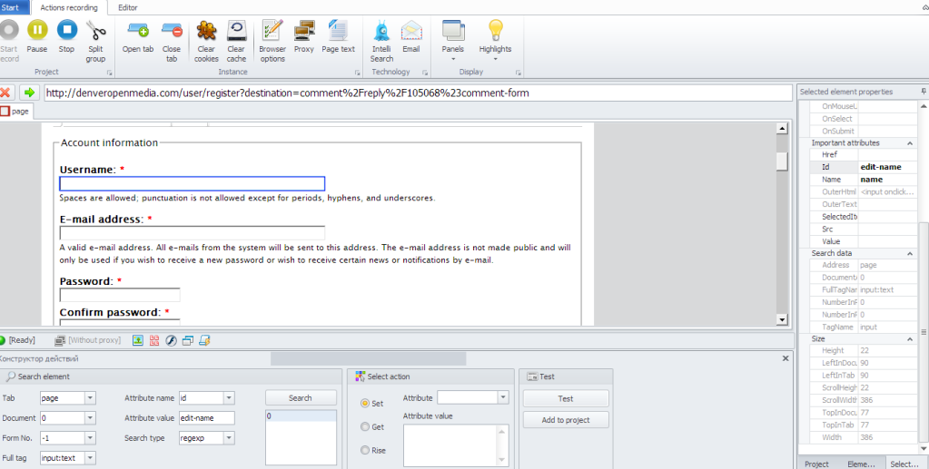

I use action designer to select the username box. How can i click the box after that. I try to change the 'select action' box to rise and click but doesnt work. I know i can use intellisearh but but its doesnt always match for for different site. For example when i fill the username for "site 1" the intellisearch fill it and save the two column(in editor) with 'search for column 1' and ' login' for column 2. But for the site number 2 it will fill column 1 with "registration' and column 2 with 'login'. So the same step fill username in site 1 using intellisearch cannot be using for site 2 and vice versa because a different in column 1. So i use action designer,change setting get from element properties like shown above and its working and detect the right username box for mutiple site i tried, but i cant click it. Anyone have answer?

You don't need to click it
Use
Set - value

Again... Set value

oh yes, i need to fill the attribute value myself..ok thanks again
