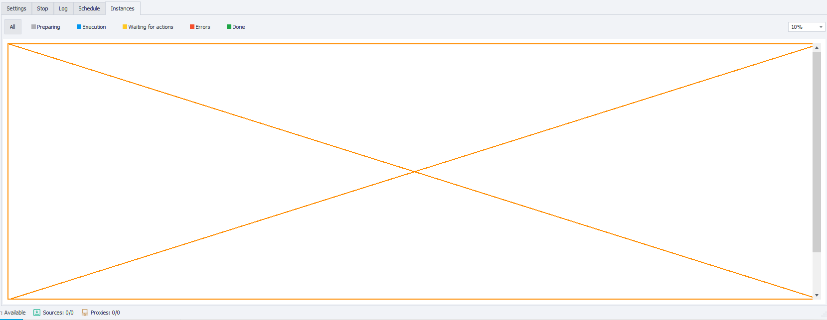

I'm having the problem with some projects that right mouse click and "interrupt" does not work. The projects keep running nevertheless, sometimes endlessly.
22 453
5 911
Not all projects can be interrupted immediately, The task is waiting until currrent action is executed, then stops.
If this is C# code acion or captcha solving, it may stop quite long...
So, what is show in the instance of non-interrupted tasks?

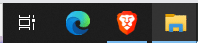

Right click on the template and open project directory option. Does not open folder but open it like this. Just in background. No folder opened.
could not reproduce... what is the OS?

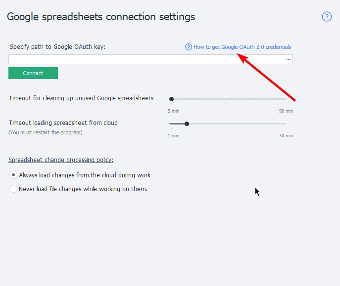

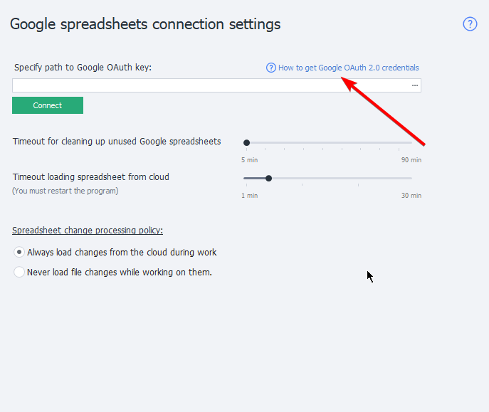

This is normal thing. It means there is no article in help docs for this functionality.
Ancor is still set because, manuals supposed to be added some day.
No, there is, and it actually worked a while back. Not sure, maybe url has changed. But there it is. https://zennolab.atlassian.net/wiki/spaces/EN/pages/1785037096/Setting+up+a+Google+spreadsheets+connection
I'm on Win 10.
