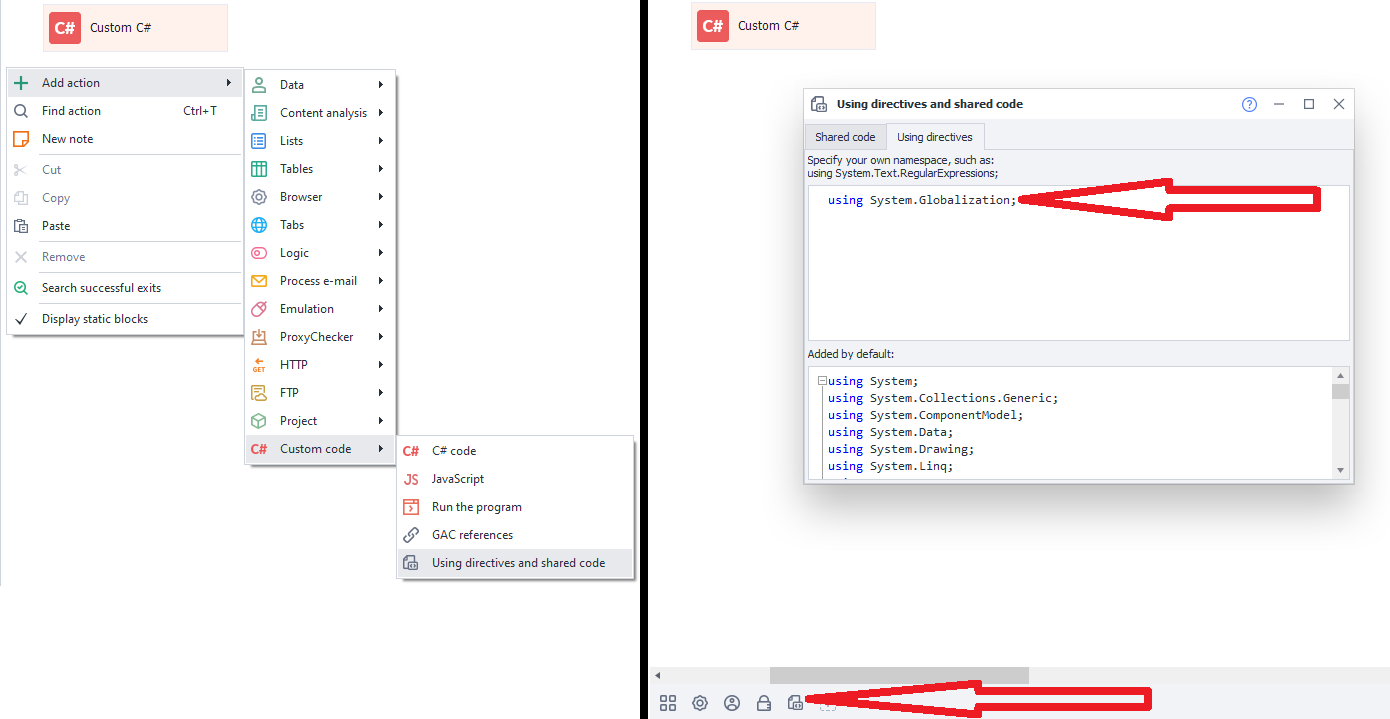

BEFORE YOU EXECUTE THIS
You need to add the line
using System.Globalization;
To your Directives & Shared code.
Im including a screen shot so you can see, to access it again you'll notice in the right-hand side a new icon at the bottom of the photo. That is how you access it again if you need to.
In this code example im taking the date in the zennoposter var DateToProcess and tossing back the unix time code.
