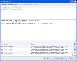

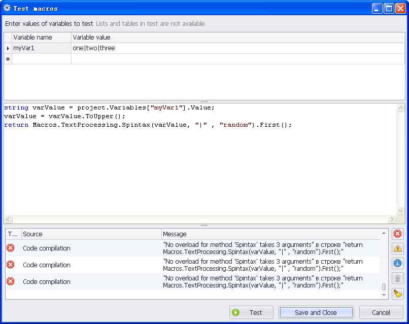

CM~422)K`LK}ZEWB]C_X@H0.jpg ?? In the WIKI the above copied down test will not work
Посмотреть вложение 3738 ?? In the WIKI the above copied down test will not work
Do you want use Spintax or Split method?
Spintax method takes one parameter (code from wiki):
JavaScript:
var yourText = "{Hi|Hey}";
return Macros.TextProcessing.Spintax(yourText);
But Split method takes three parameters (code from wiki)
JavaScript:
var yourText = "email:password";
return Macros.TextProcessing.Split(yourText,":","all").Count();
You something mixed up when you have copied code. I should say in documentation all correct.
