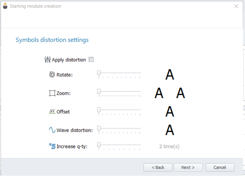

Hello, I'm having an issue where my custom module captchas are considered "complicated" and therefore have a long 5-10 second starting delay. The actual solving time is really fast though 0.01s. I need to figure out why the captchas are considered complicated and how to fix them.

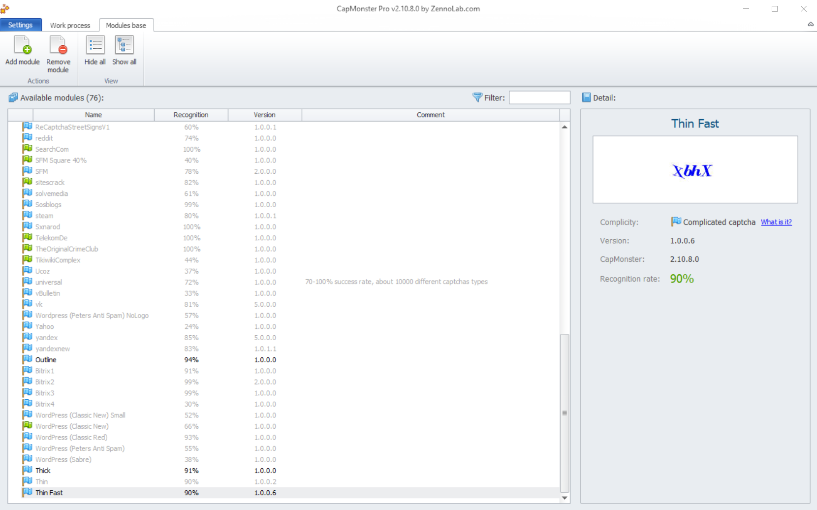

My captchas (the ones enabled) have the blue flag and are considered complicated captchas whereas the green flagged ones are simple captchas. There is a simple captcha that looks very very similar to mine in the way it is distorted.

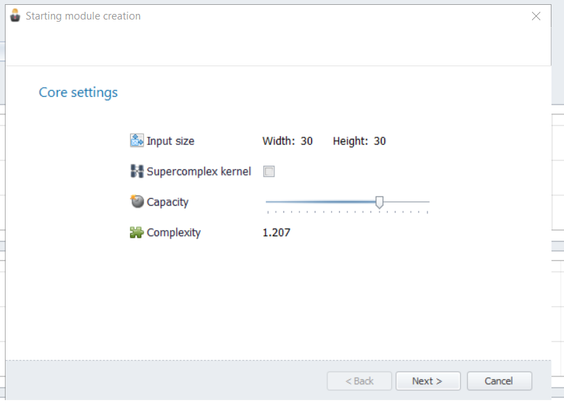

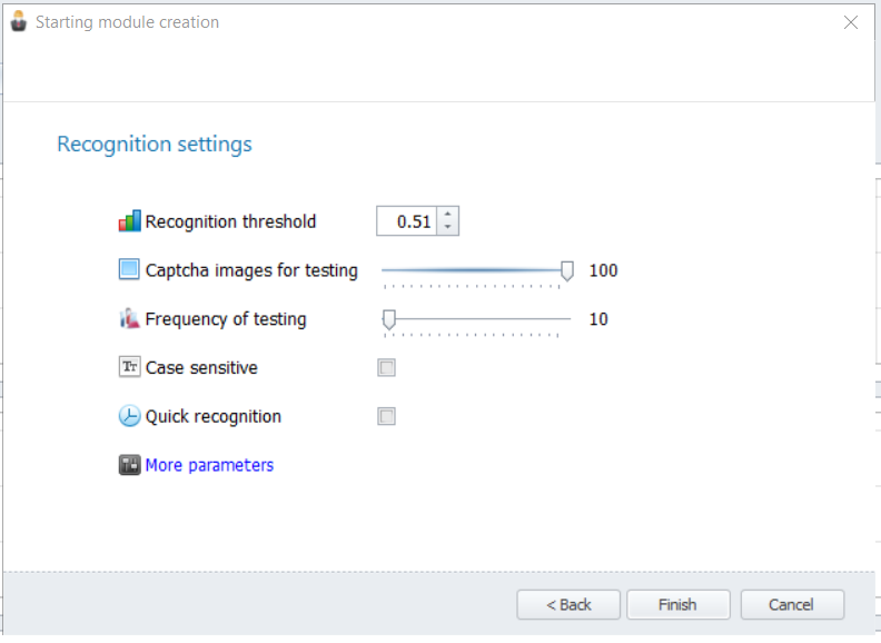

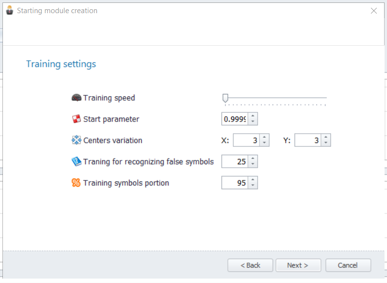

Here are my training settings.

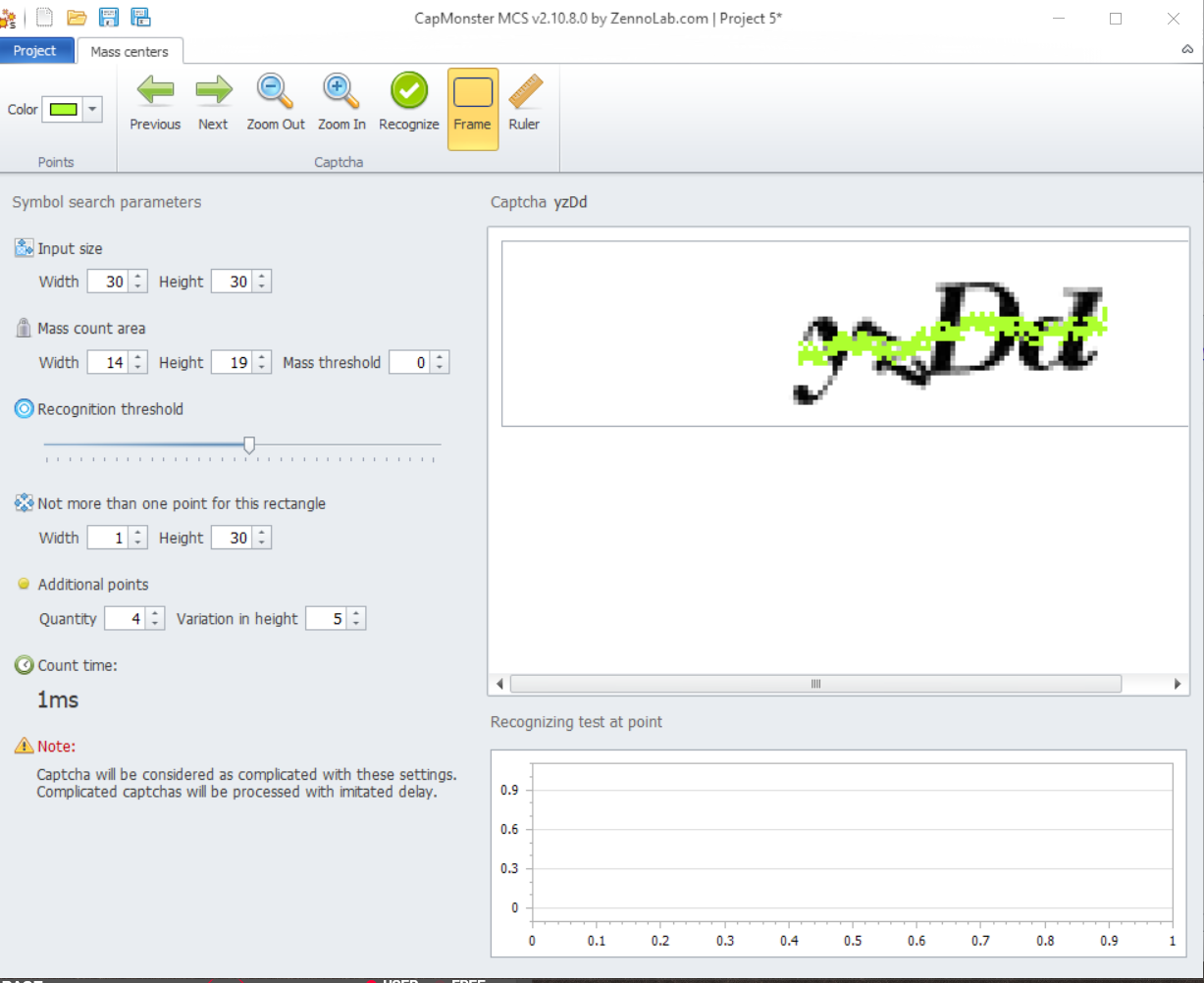

Here is my mass center:

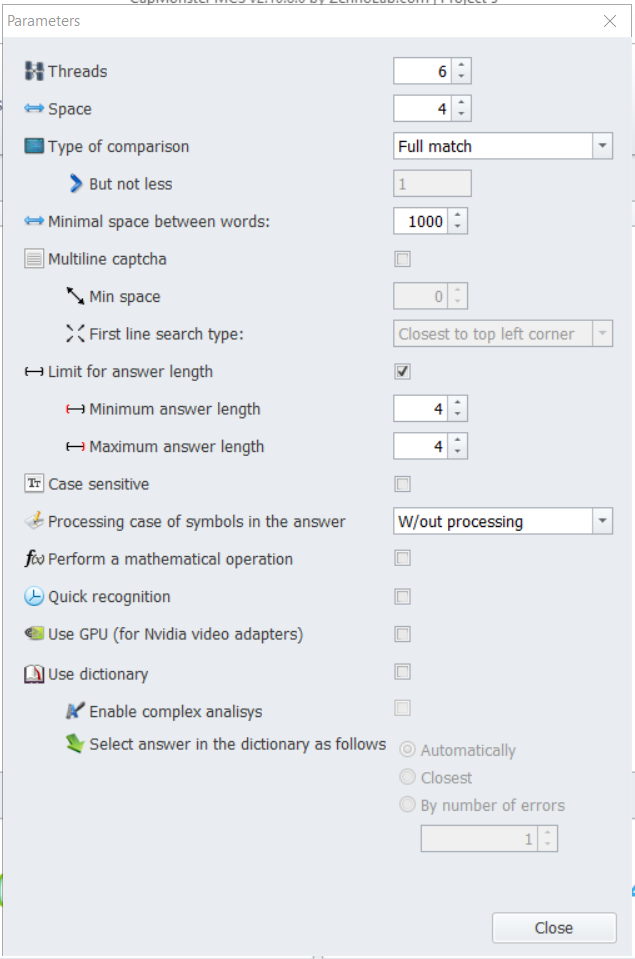

I have tried changing the settings completely in the mass center and reducing the dots but the Note at the bottom is still there.
So how do I make my complicated captcha into a simple captcha so that I do not have any delay?

Fought with this for another day. Still can't figure out how to get rid of the delay.

First of all, you should set less number of mass centers.
Could you please attach your module?

I have tried reducing the number of mass centers but its still considered complex.
Here is my project file
