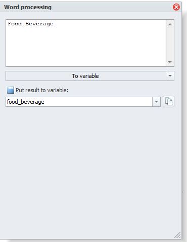

I have variable of context recognizer ok, but how would I compare to a context category I define? Because everyday, the context category I need to target changes, so I need to define somewhere. So I tried this:
I tried putting context category Food Beverage in word processing, then put that word to variable. I've then tried to compare with IF, but it always goes to bad exit when both variables match. The IF I used is:
{-Variable.result_of_context_recognizer-}=={-Variable.food_beverage-}
Hungry Bulldozer
12.01.2011
3 441
834
Could you attach the template sample?
bigcajones
09.02.2011
1 216
683
They are strings, you should delimit them. '{-Variable.Name-}'=='{-Variable.Name2-}'
