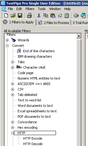

nevadahsot
27.04.2012
106
Maybe this will help if encode decode large list.
Hungry Bulldozer
12.01.2011
3 441
837
ladygamer
04.03.2013
17
thank you so much :-)
