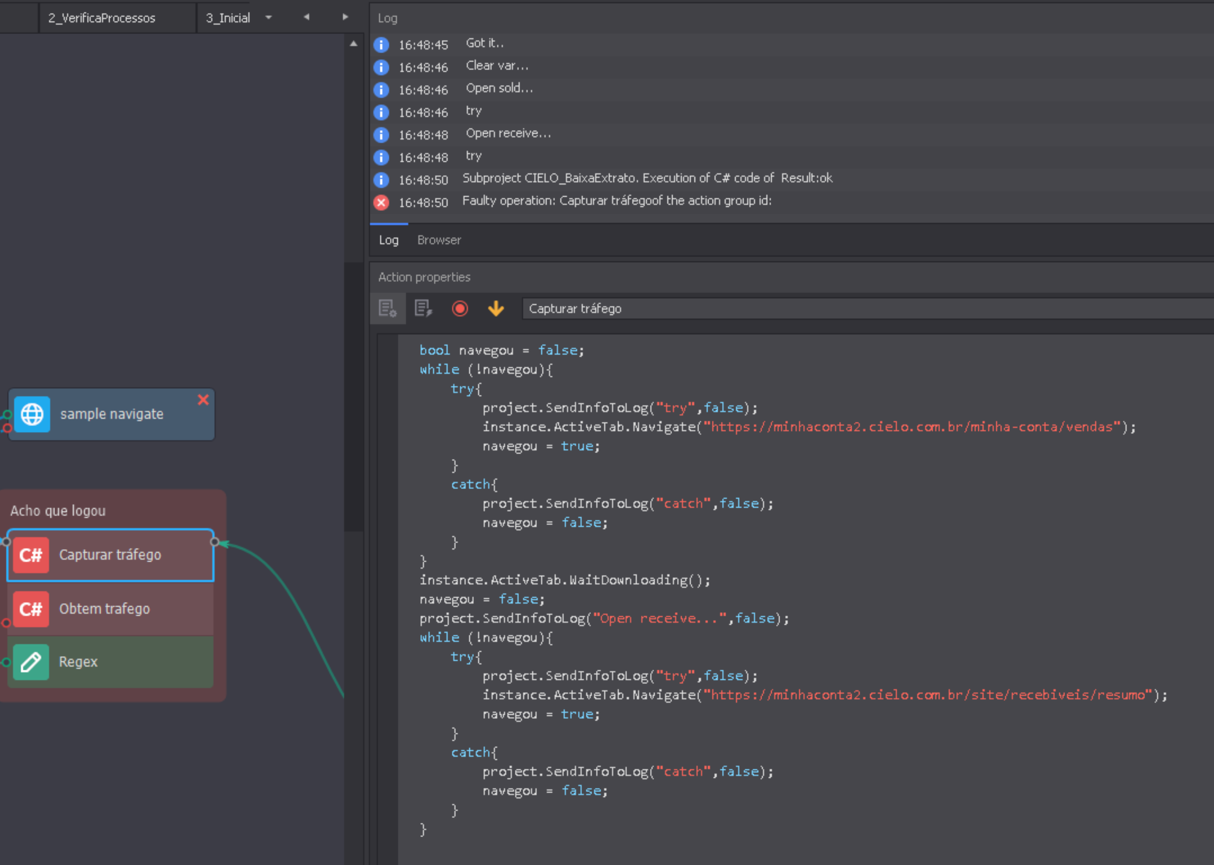

This happens because of canvas super emulation error.Sometimes, while chromium (beta) is the browser the "navigate" (go to page) action fail.
I've tried it with C# too, and the error can't be catched, it will be error forever.
It will ignore error condition and the next action is bad end.

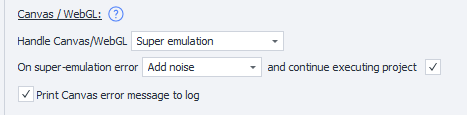

At log, it says something about canvas error:
[2024-06-14 16:49:08.6448]|88||ProjectPlayer canvas effective mode: SuperEmulation
[2024-06-14 16:49:08.6448]|88||C:\zenno7\administradoras\CIELO\CIELO_BaixaExtrato.zp, hashes=5d55be851fc8c310730435d9608663fa a7767b0853eac12d3eb66abaa1178379 canvas emulation fails

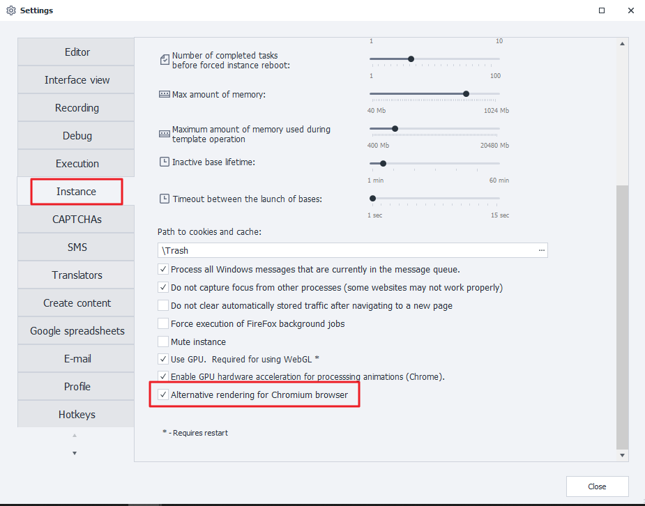

I applied the alternative rendering and it still restarts the PC.Perhaps, you need to make clean installation of this version.
Also, adivse you to enable alternative rendering in program settings to avoid restarting.

Please enable detailed log for developers in program settings, reproduce restart problem, then make Diagnostic report, see instructions here.I applied the alternative rendering and it still restarts the PC.
Then I reinstalled ZP 7.7.15.0 fresh but it still restarts the PC randomly after a few hours.

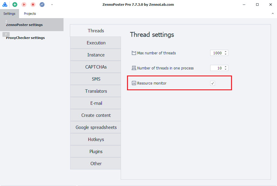

Please check if this option enabled in program settings.I submitted the files
We believe restart is caused by Intel processor heating issue.It is enabled.
