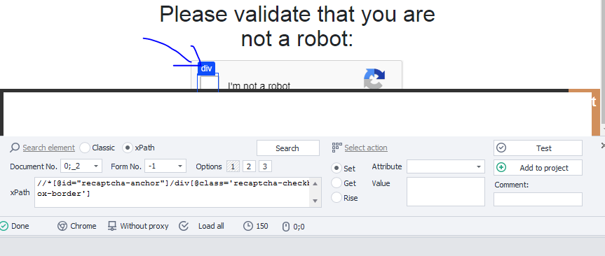

hello colleagues wanted to know how to select an area of a web where it has "recognition if you are a robot", I have analyzed the web and has a div where you have to click with the mouse and you jump to fill the captcha.
the first step would be to add the option of mouse click on that div?
and then add the captcha recognition option?

Hi. Just add action Recognize ReCaptcha and it will do the rest.

Thanks... the action of recognizing captcha I add it after the action gotopage not?
and within the action of recognizing captcha i have to contract the capmonster?

You add it where captcha is, and where you want to solve it.
Please look into action and You will see that there are recognition modules, if You set it as CapMonster then yes you have to have Capmonster. If You set other then use the service you set.
