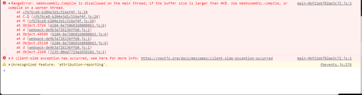

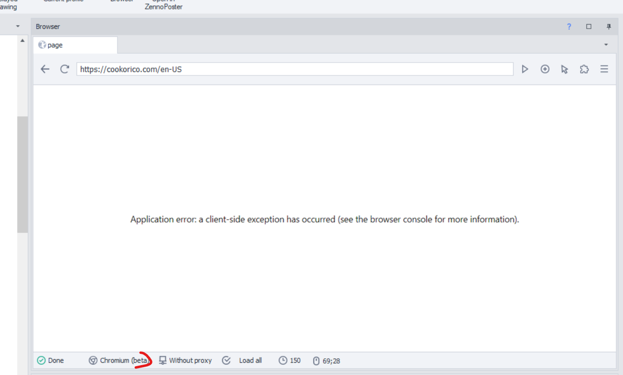

Hello everyone,
I have the same problem as Cesario. Here are the screenshots. I know that live, those who encounter this problem have a browser that is too old.
With ProjectMaker,I still get the same error even when changing browsers in the settings.
Do you have a solution ?
Thanks for your help

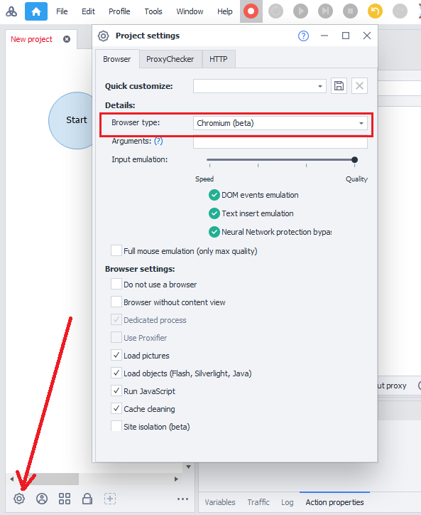

You should switch browser type to Chromium. CEF is quite old alrready.
Select Chromium in project settings and press restart the project.

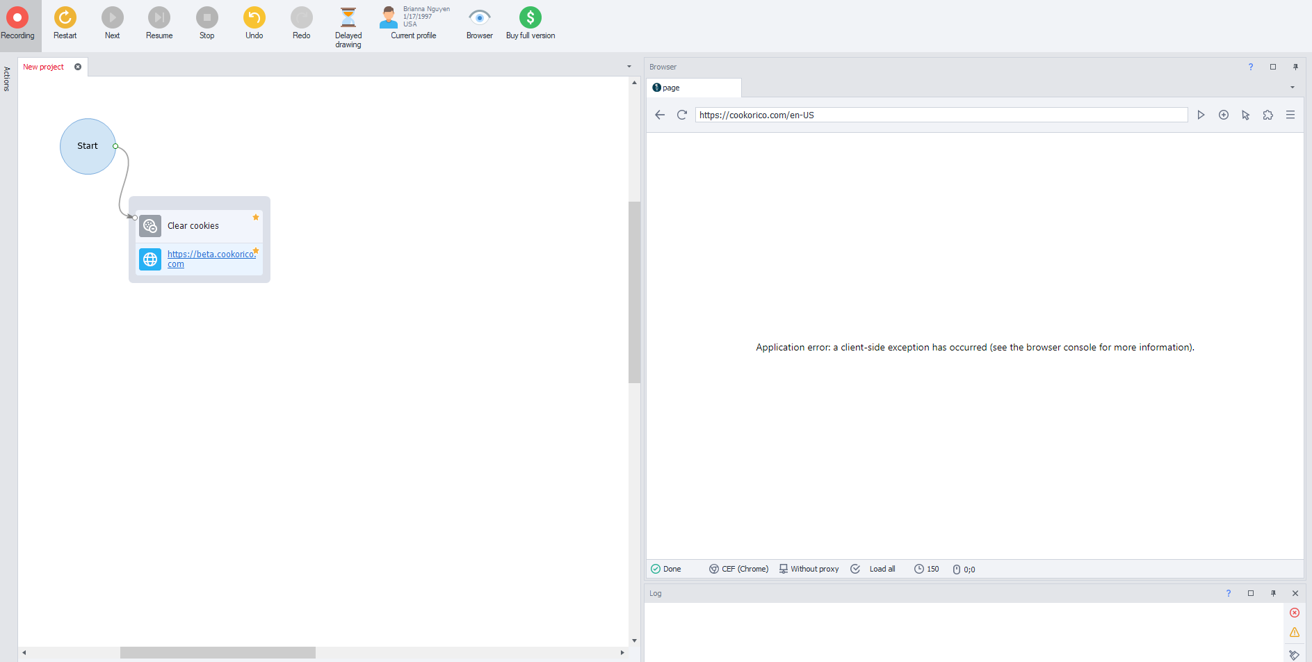

KJZenno
23.01.2023
Thank you for the answer.
But it still does not work.
  • 72 КБ Просмотры: 16

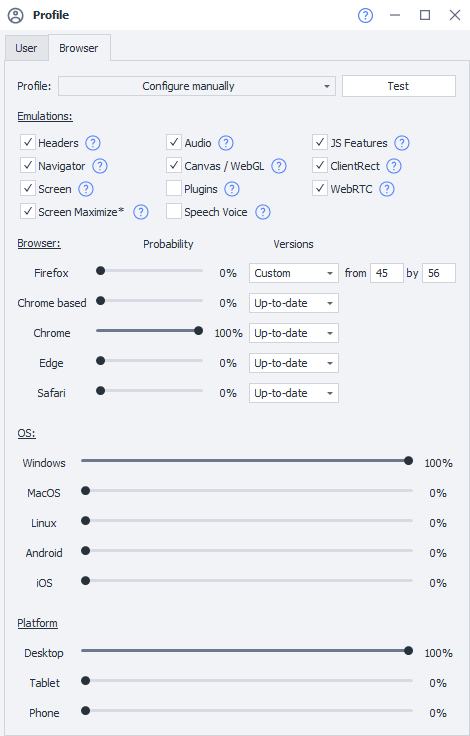

This works for me. What browser profile settings do you select? and what ZP version do you use?

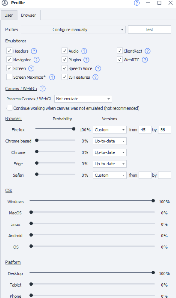

KJZenno
23.01.2023
I have version 7.7.0.0
Profile settings :
  • 126,9 КБ Просмотры: 18

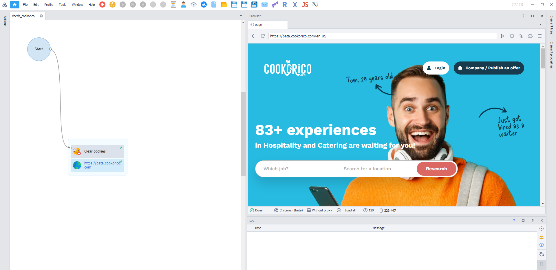

KJZenno
23.01.2023
Indeed, it works with the latest version (demo) !
Thank you very much for your help and your responsiveness.
