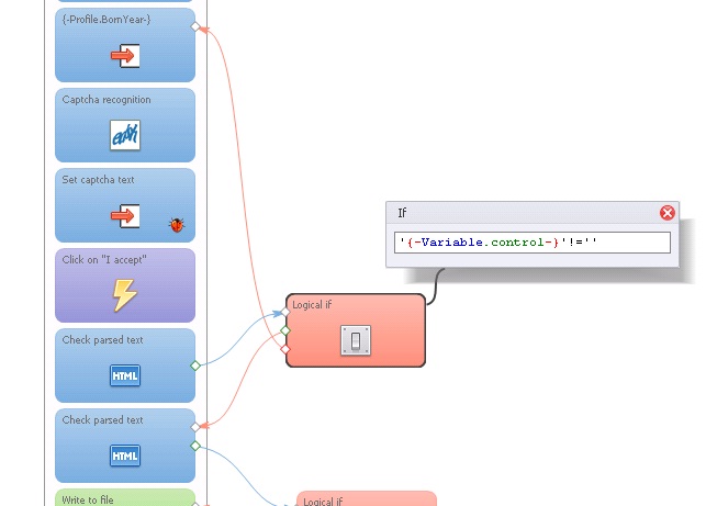

hi to all I need some help with a logical if
  • Автор темы Автор темы albaniax
albaniax
18.12.2011
29
i have this problem with logical if he return false and sometimes he don't return any value so in debug the if result is blank , whats happen even when the vale of the variable is == blank he dont return nothing and goes to control captcha again , the vale of the variable is correct when captcha its ok control == ' ' , and when captcha it wrong != ' ' , but he return and return to control captcha
i tried to change the direction of the logic output but don't work again
blank result (not true and not false) for If action happens when you're trying to parse something containing quotes or multilines. Try to keep text to look for short and simple.
it works now to simple :) thanks
