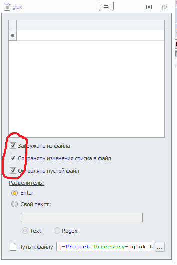

1. have an action in each template - list processing, add line, write result and some info, which tells you what template it is - and make sure to set up all three checkmarks for this list, i.e. load from file, save changes and leave blank (here is screenshot, but it's in russian))
2. make sure all templates refer to this same file. This set up is good for multithreading, since you have this checkmark (save changes).
The only thing - it will NOT save result of particular template to the particular line. But, as I said, one way around it is just to have info about your template along with the result line. Hope I understood your question.

I would try the following:
