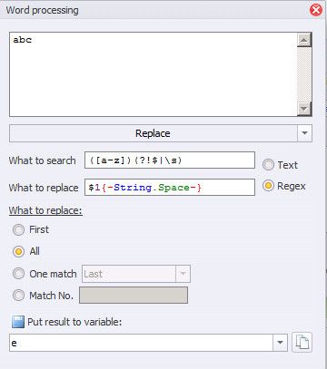

How to insert a empty space between letter?
abc-> a b c
how to use space replace letter?
'abc' use space to replace 'b' -> 'a c'
Thanks!:confused:

([a-z])(?!$|\s)

my guess would be that question was about using replace with zenno... :D
this is what you use for replacement with space {-String.Space-}

Thank you drvosjeca! {-String.Space-} works great!:az:
