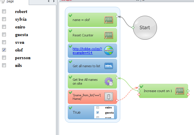

Hi,
I need zenno to find that name that i have it stored in a text file and once that is found, click the check box there.
The names in the list are random, so it will need to search for it and align to the check box.
Can someone help me select this check box?
Best
Dikkill

Set a variable to 0 (zero) - A counter.
Create a regex to grab ALL rows of what you've named "Find" in your print and put them to a list.
Take the first line from that list and compare if it matches your "name".
If it's:
False - Increase the counter by +1 and take next line and let it loop.
Once it's True - Now you got the number of which match that checkbox has. Change the value/click the checkbox with match number {-variable.counter-}.
Tobbe
01.08.2013
428
148
Here you have a live example
