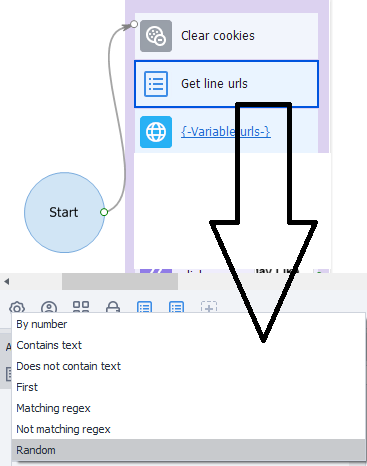

I have the following question, I have created a list called "urls" and then I would like to visit the urls as they are on the list, without being random, so what is the right choice?
Hey, bud, I'm all hands for helping with, but if You really want to succeed, then I suggest TEST.
It would be way faster if You could move through all options and see what happens :-)
Not only you would find one that works for You, but You would also understand what other options do. :-)
This time if You want to visit all URLs one by one then You just take the First line with deletion.
So when next time it will run it will take the first line again, and so on.
