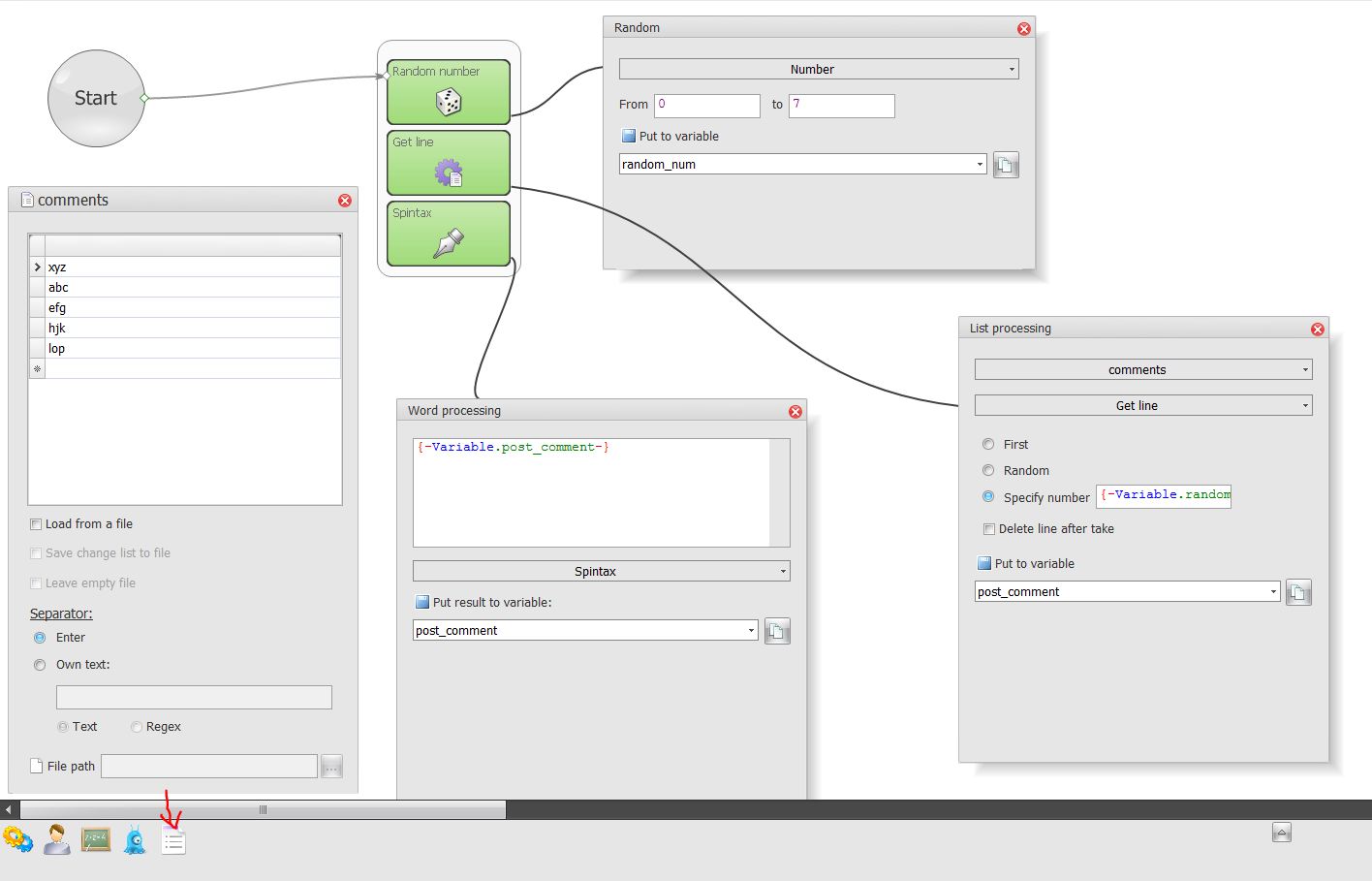

I'm not sure if this is what you want...
If random number generated is "1", then "abc" will be put to variable {-Variable.post_comment-}.
There after, use the variable {-Variable.random_num-} and {-Variable.post_comment-} for whatever actions.

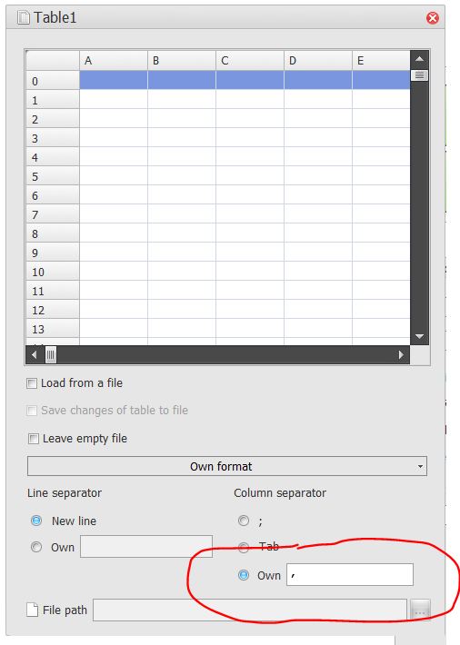

I'm reading a lot of lines with a lot of columns from a file using table processing. Then I store these values into the variables.
One variables will have values like - {abc|ghk|},{eft|thy} and so on. This can be a long list of variables which are , separated. Now, I want to break this variable in such a way that it returns me another table with all the data of this column as rows.
Attached is the pic
Here, I'm filling the new table which has ',' as new line separator. I'm giving input to this table a variable which has values as ',' separated.
Then I'm reading the tables's first column.
But, the table is not separating the variable into n number of rows taking ',' as the separator.
Am I doing something wrong here?

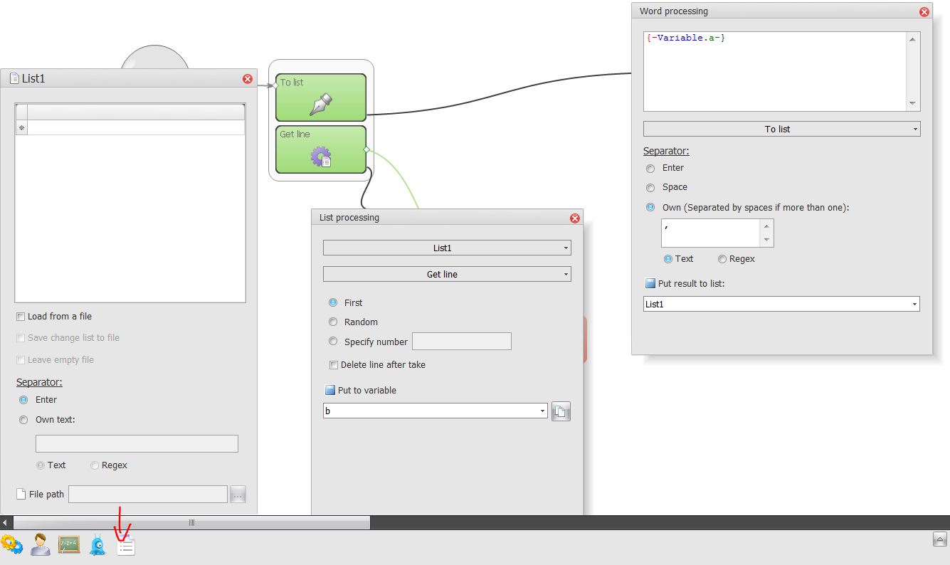

Are you trying to turn this
{A|B},{D|C},{X|Z|V}
into
{A|B}
{D|C}
{X|Z|V}
If you are, you should try this.
Use list, instead of table.

If you just want to have {A|B},{D|C},{X|Z|V} separate into column A, B and C,
you should have ',' as column separator (not line separator) in table setting.

Yes, I'm trying to transpose it by turning columns in rows. I hope this should work fine.
Anyways, for the time being, I've fixed the code to some defined number of elements and used these as different variables instead.
Thanks for your help. Much appreciated.
