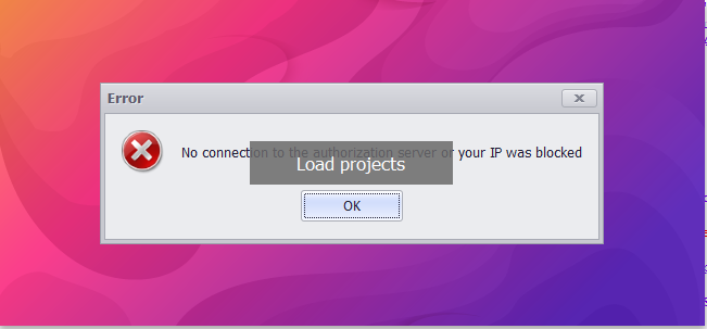

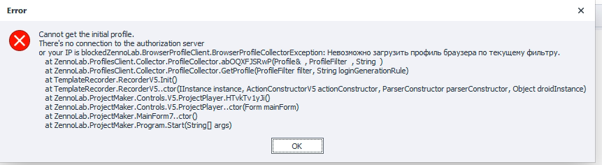

"No connection to the authorization server or your IP was blocked"

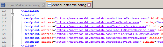

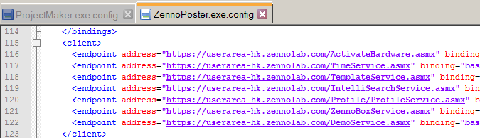

Can't open ZP even after switching to userarea-hk, -us, or userarea.zennolab.com in the .config files.

@VladZen Please check. It's urgent. It seems some localized issue, because i also sometimes get this error on my client server and even some HTTP requests don't work. While on my PC it all works fine.

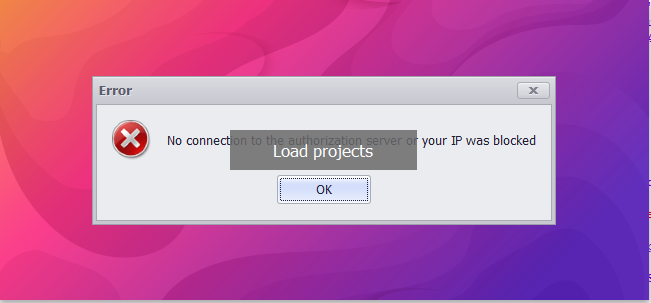

We are getting this. And some HTTP request don't work as well. That's weird because some works, and seems poster i can open. PM i can open sometime also, but most of the time there is this error.
22 619
5 962
To avoid this error try reinstalling ZennoPoster and installing the latest version.

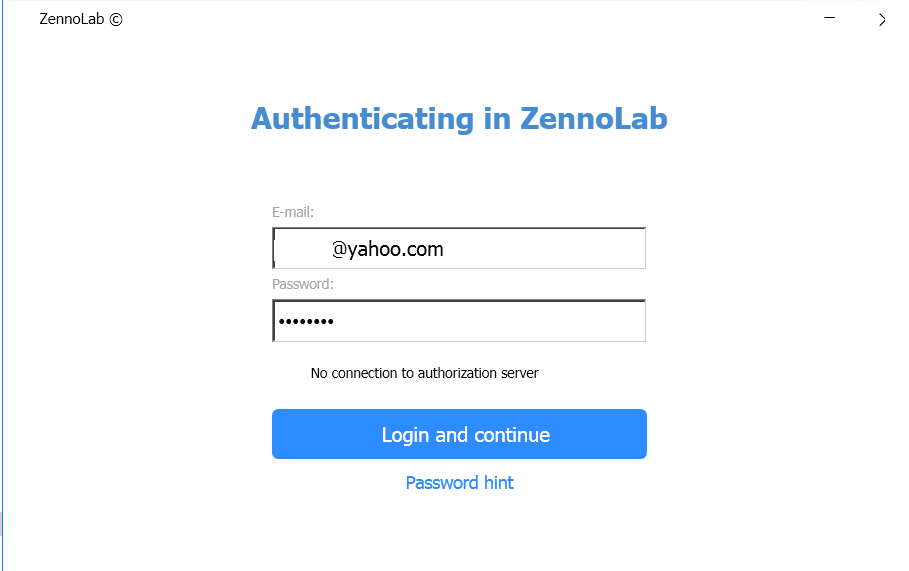

Can't even install a newer version.
"No connection to authorization server" during product installation.
Problem appears to happen on Windows 7 machine but not on Windows 10.
It appears that something on the authorization server was changed in the past few days to not supporting Windows 7 connections.
I don't think something was changed related to Windows 7.
Do you install the latest ZennoPoster or some old version?
Please attach installation log - ZLInstallerLog.log file from local drive C.

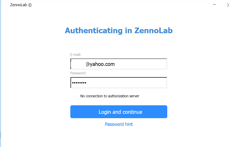

Have you managed to make it work?
No, so I had to migrate the whole system to a Windows 10 VM, on which it works.
But the Windows 7 didn't, even though both VMs were on the same host.
The Windows 7 had been working for years until about two weeks ago, then all of a sudden (with nothing changed on my side because it's a simple and stable setting) it was refused connection to ZP/PM authorization server.
Unfortunately, Windows 7 is not supported even by our system requirements.
Also, virtualizing program copies is not allowed by license agreement, FYI.
