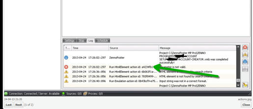

This is the error.

Make a screenshot of this action's settings:

Big thanks to Bigcajones for helping me solve this.
Apparently it was finding multiple images and getting confused or whatnot.
I eliminated the group 1 entry in the cap recognition data and it's now working like a champ.
