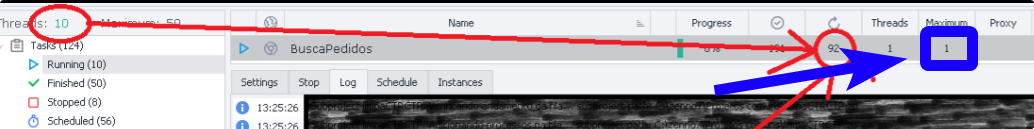

I have 10 threads running, 92 new repeats to do.
The project ends at 13:26.
At 13:33 the thread keeps running with nothing to do.
But, the project uses only one thread:

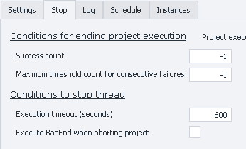

We set timeout to 600. Sometimes (80% of times), timeout not work too.

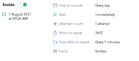

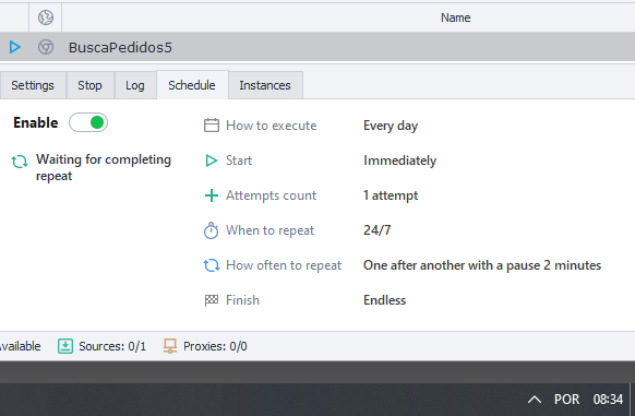

Here is sheduler settings:
80891

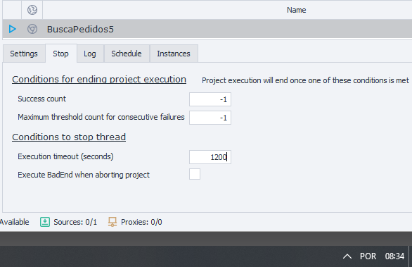

10% maybe are problems in projects, but the timeout is not working.
Look this:
80889
80890
Maybe there is a problem with html not found (maybe cookie expired) but the error have a correct treatment. There is no reason to project crash and, if have another random problem, the the timeout isn't work.

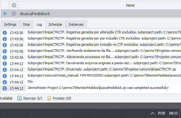

Crashed again tonight, projects never end.
15 hours and never end... still "playing"...
81185
Sheduler settings "waiting for complete" a task who "completed successfully!":
81186

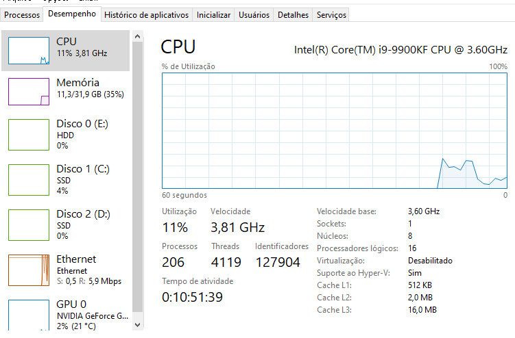

Resources:
