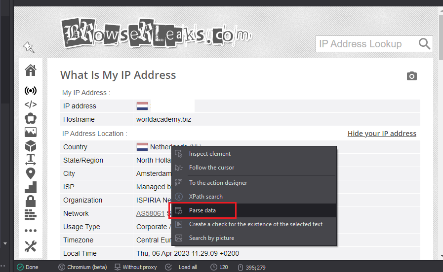

You can automate checking location on a website.
Just open the site and parse detected location from it.

Você pode automatizar a verificação de localização em um site.
Basta abrir o site e analisar a localização detectada a partir dele.

You can parse the state with Parse data
check the result in Switch logic and depending on the result value go to required actions.

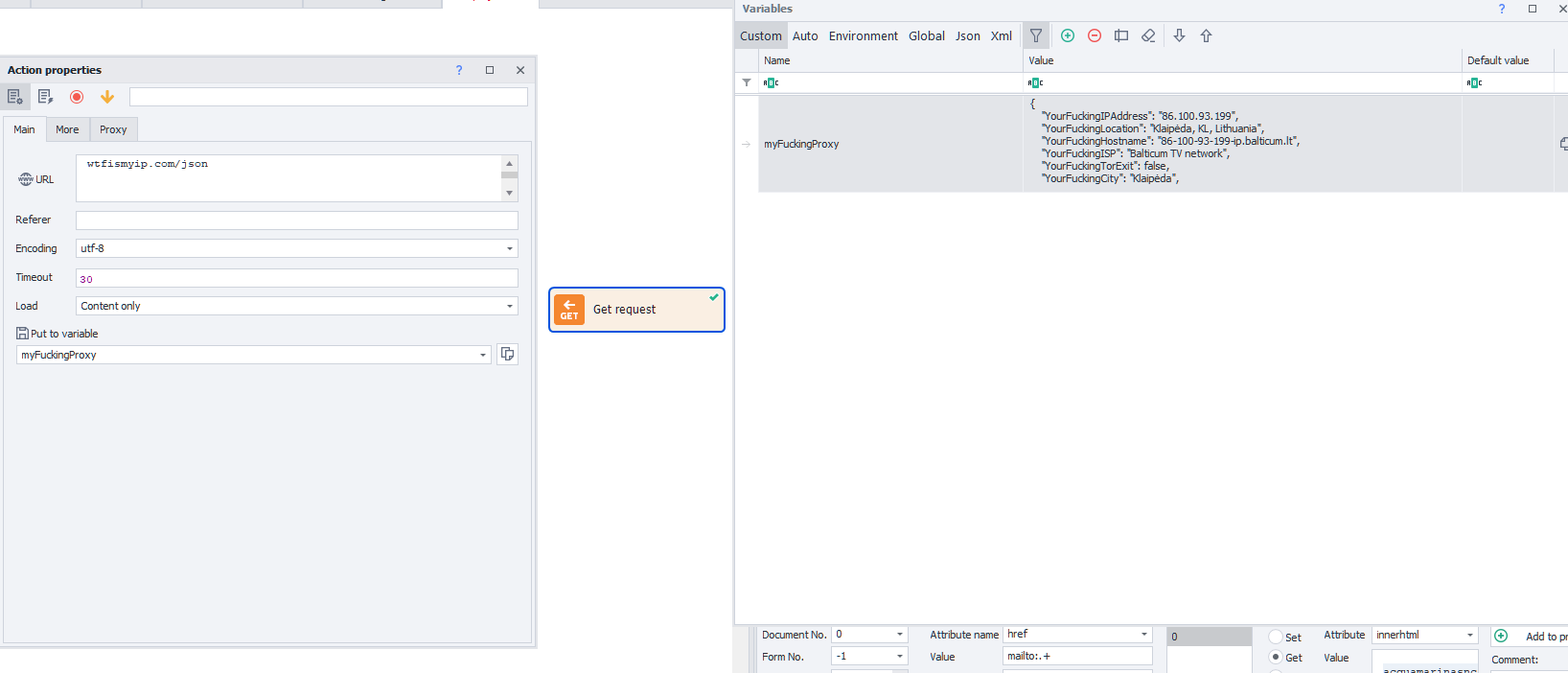

Just a simple GET request (don't forget to add your actual proxy in the cubes 'proxy' tab)
And you get all the information needed neatly in a JSON format. Use "JSON processing" cube to get a single field that interests you.
105633
Or using C# you can also test the speed of that proxy at the same time, it's pretty convenient
        var timer = System.Diagnostics.Stopwatch.StartNew();
        string getas = ZennoPoster.HTTP.Request(
        method: ZennoLab.InterfacesLibrary.Enums.Http.HttpMethod.GET,
        url: "https://wtfismyip.com/json",
        content: "body",
        contentPostingType: "application/json",
        proxy: project.Variables["proxy"].Value,
        Encoding: "UTF-8",
        respType: ZennoLab.InterfacesLibrary.Enums.Http.ResponceType.BodyOnly,
        Timeout: 8000,
        Cookies: "",
        UserAgent: project.Profile.UserAgent,
        UseRedirect: false,
        MaxRedirectCount: 5,
        UseOriginalUrl: true,
        throwExceptionOnError: false,
        cookieContainer: project.Profile.CookieContainer,
        removeDefaultHeaders: true);
        timer.Stop();
project.SendWarningToLog(timer.Elapsed.ToString(),false);
project.Variables["timeSpent"].Value = timer.Elapsed.Milliseconds.ToString();
return getas;
Your proxy should be in variable named - proxy
