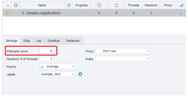

It is not recommended to loop projects.
  • Save all the URLs to a file.
  • Bind the file to a List.
  • Take lines from the List with deletion.
  • Navigate to the URL
Add this project to ZennoPoster. Add as many "Attempts count" as you have lines in the file. So one project execution will process one URL.

I have that setup right now actually; but, my issue is that I'm not able to see the bot work on the website after it's completed 1,000 URLs.
After the bot has completed 1,000 URLs, I would like to go back through the 1,000 tabs and see if every website has said "Completed".
nicanil
06.03.2016
2 242
1 810
You can navigate to the URL, do all you need to do, wait for the "Completed" message, and then process next URL.
