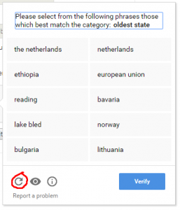

Hi,
I want to create C# code to click on reload icon for RC2 Associations
ProjectMaker does not recognize when I click on it.

I tried to changed the "id" to "recaptcha-reload-button" - this is actual id of reload button
But it does not work. I also tried using "actions designer" but nothing worked.
How can I make a macro (in C#) that clicks on the reload button?

var noaudio = tab.FindElementByAttribute("div", "id", "recaptcha-reload-button", "regexp", 0);
noaudio.Click();
