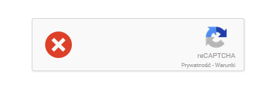

I've been using Recognize Recaptcha v2 module (without CapMonster, just the one in Project Maker) and I was wondering how to make ZP check if solving failed and then retry it until it's solved correctly. It just marks the recaptcha v2 box with a red X and stops Project Maker but I don't know what to use as a variable here.

Use simple logic, if this failed then it goes out to red dot, so connect loop there and repeat.

@lokiys this might sound like a stupid question but... what do I put in the logical if? I can't find a way to put wrong captcha recognition into a variable :/

1. You need to initialize counter, add variable captchaLoop with default value 3 for example.
2. If captcha is answered wrong it goes out to red dot. Connect to red dot action - decrease captchaLoop variable by 1.
3. Add IF action and check if captchaLoop variable is bigger than 0 if yes then go back to resolve captcha, if its 0 then end template with error.
http://zennolab.com/wiki/en:looping?s[]=counter
