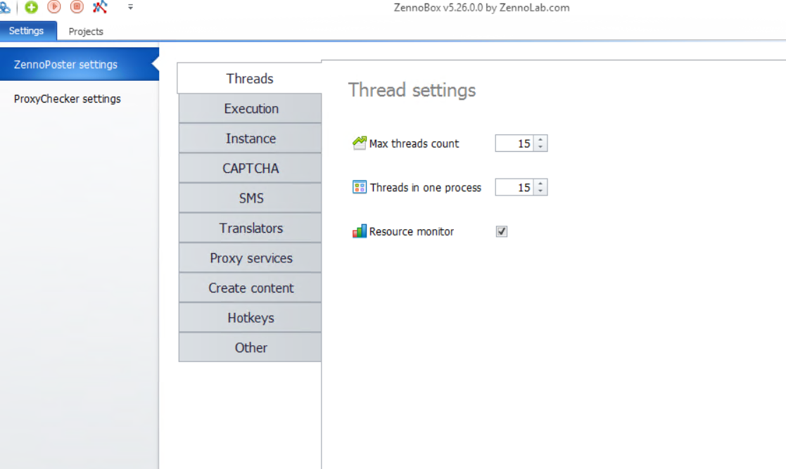

Hello,
I recorded some test about threads, maybe something missing please check the video:
I put maximum 15, but zenno never go back to 7,8,9 threads, only first time, allwats stuck on 4,3,2 and on end 1 thread:

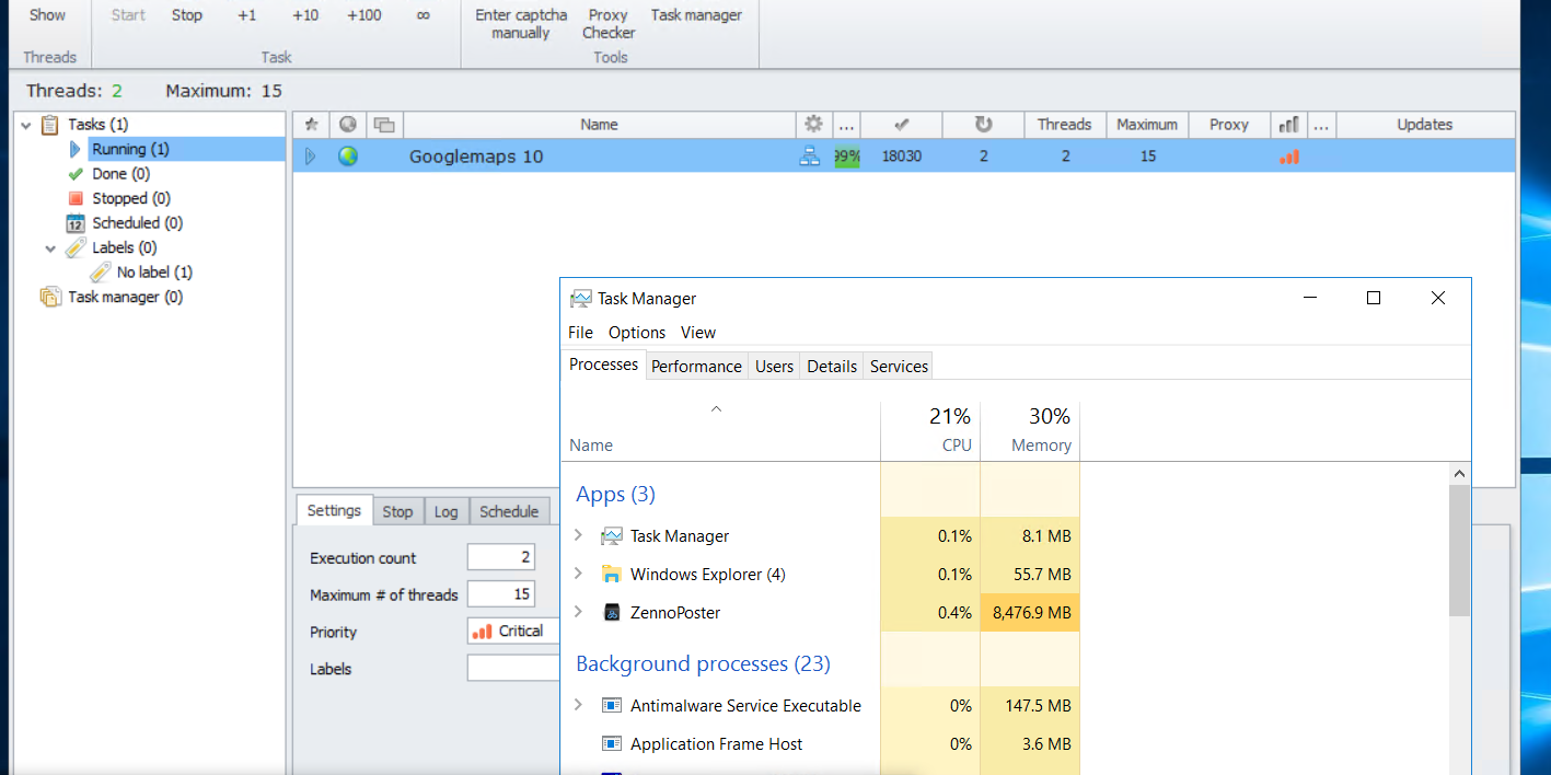

update after 15 minutes, still is on 2 or 1 thread, never go to 5 or 10

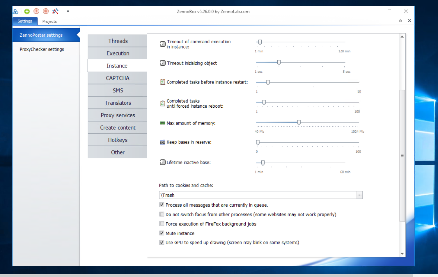

What about instance settings in program settings?
Also how long is template executed?

Please tell me more about it " instance settings in program settings" where is that?
Template load google maps page put keyword click take data and stop, with pauses maybe 30 seconds maximum
Now running ONLY 1 thread

ok, this? Ok it is stay by default ?

Threads in one process - you should reduce it to 5 or even just 1.
Your project is very short, the program just does not have time to run all possible threads.
When new thread is starting, first is already finished.

i can increase some pauses, but if zenno can work with a lot threads you want to say that is normal to i can run 2 threads only ? It means for 30 seconds it can not run more then 2 threads, it wait more time ? How long, maybe faster will be if i increase some pauses and get more threads ? And there i not way to force more threads for template of 30 seconds ?
I now decrease threads in same process, but same running 1 or 2
22 413
5 900
You are misleading me..)
How do you expect to run 15 threads with 2 execution count?
22 413
5 900
To run dozen threads you should have several minutes long template with several dozens execution count.
