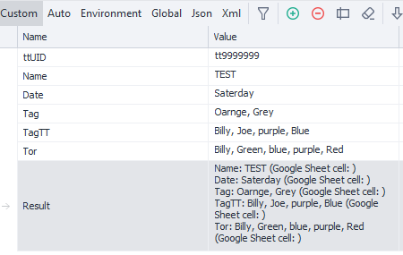

Ok ive TRACED & scaled back bit to see wtf is going on/wrong
apparently i can not call the google sheet cell data?
I can search it sure, but i have NO idea why i cant call the data in the cell's
If some one could explain what is wrong here

Log Results сказал(а):
Execution of C# code of Result:Name: TEST (Google Sheet cell: )
Date: Saterday (Google Sheet cell: )
Tag: Oarnge, Grey (Google Sheet cell: )
TagTT: Billy, Joe, purple, Blue (Google Sheet cell: )
Tor: Billy, Green, blue, purple, Red (Google Sheet cell: )
100674
100675
100676
Table сказал(а):
tt9999999Fridaygreen, Red, appleBilly, Joe, purple, Blue
I Dont know where im going wrong here.
Its defently strange im not even pulling the data, the sheet does find the row accurately but. yeah im at a real loss here
So if some one could point me in a solution for getting the CELL data
