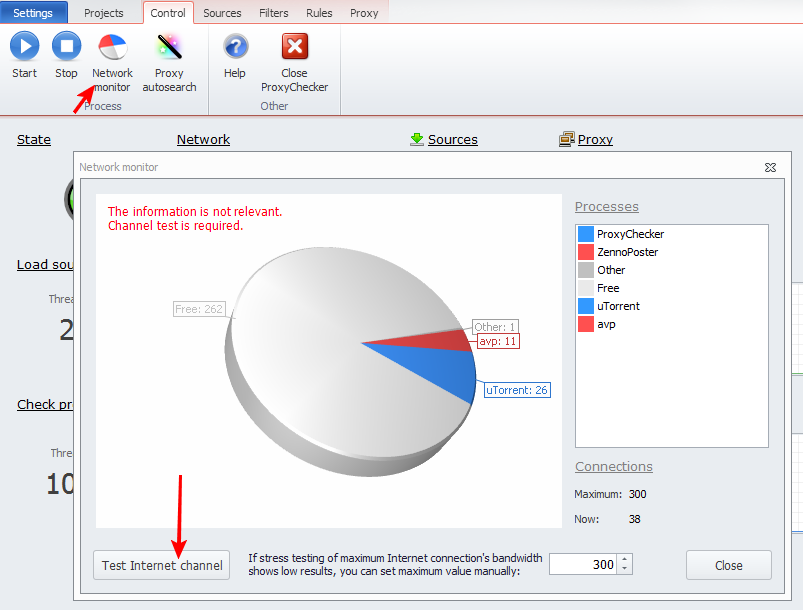

I've tested router WNR3500L it can handle 350 connection not 2000. Also I tested ASUS router It can handle approximately 700-850 connections not 30k.
I thought the main difference is that ZennoPoster creates and destroys huge amount of connections. It is not constantly existing connections. ZennoPoster we have built in tester. Please check you real situation.
To help me with that, can you tell me from your experience what other things might factor this and help increase success rate while using 200 threads?
If you are using HTTP try to switch from http to socks proxy. And if it is not critical for you set back to default 5 thread in 1 process.

I've just tested and the result was ~1000 connections, does it mean that I can use 1k threads maximum, or it indicates something else?

what impact does it have if I switch from private proxies to socks proxies?
socks proxies creates tunnel and do not close the connection. Sometimes it helps to avoid not predictable error. But it depends from the socks quality. In any can try to switch to socks it helps for somebody.
This means you system can handle 1000 connections simultaneously and nothing else.
Each zennoposter thread can open from 1 to 16 network connections. Also proxychecker need from 1 to 3 network connection per each checking thread.
Also other running programs on your computer may require network connections.
