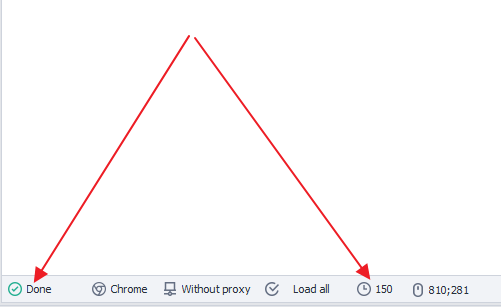

What do you have here when an action fails?
Реакции: myndeswx
