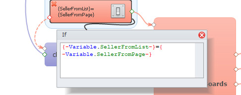

Hello,
I would like to know where it is possible to find the list of arguments that can be used with the variables ?
Here are some examples that I would like to use in "IF" :
  • If I need to say that {-Variable.myvariable1-} is equal to {-Variable.myvariable2-} ? I try {-Variable.myvariable1-} = {-Variable.myvariable2-} but it doesn't work.
  • If I need to say that {-Variable.myvariable1-} is not empty
  • If I need to say that {-Variable.myvariable1-} is empty
  • Etc.

Hello,
  • Etc.
I looked in the Wiki (https://zennolab.com/wiki/en:variables) but I didn't find anything about it and I would like to learn the different arguments that can be used.
Can you help ?
Thanks :-)
You must use quotation marks to compare string values and variables.
More details here: https://zennolab.com/wiki/en:logic

Also, your equality is spelled incorrectly, it is correct to use this:
43718
Реакции: Desto
