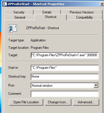

Yes, this has been happening a lot on my 5.10.6 and 5.11.5 so I made a little program for it.
It simply starts an endless loop that checks is ZP is active.
If not it starts it up.
then it goes to sleep for the duration of the first parameter.
the second parameter is the location of your ZP exe file.
I just placed it in the program files folder and use a shortcut to start it

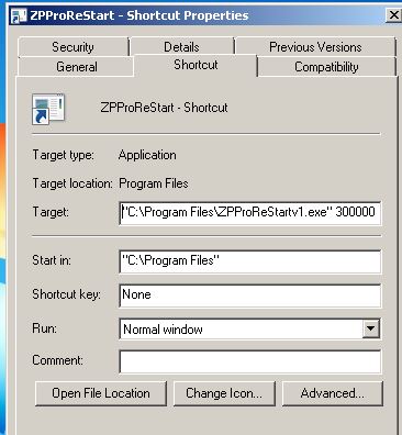

and I also put it in the startup folder so it will start up when the machine starts
to start it
"C:\Program Files\ZPProReStartv1.exe" 300000 "C:\Program Files\ZennoLab\EN\ZennoPoster Pro\5.11.5.0\Progs\"
You might need to use the alternative folder name to create the shortcut (PROGRA~1) to avoid the double quotation.
-300000 is the pause time in milliseconds (5 min) (make sure the time is more than your ZP takes to load)
-the location of ZP may change depending on how you update, so if the version is in the path , you will have to update the shortcut
after it starts it just sits in the task bar.
Hope that helps
