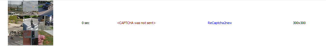

2. I get quite a lot of "captcha was not sent" errors, what does that mean?
74428

2. Error caused by issue 1.
