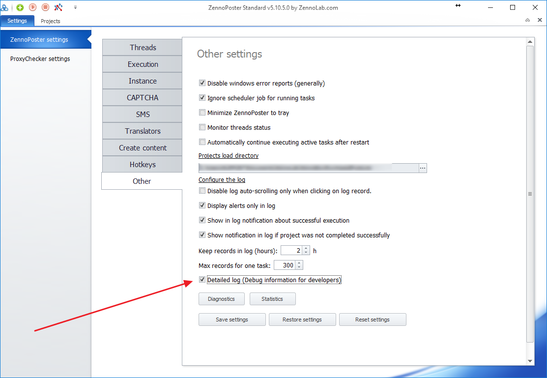

There it is again.
I have worked with templates without a browser.
Then opened template what required a browser and there is this https://i.imgur.com/yWNtbeB.gifv
It seems like the browser is working without the content view, no I do not have content disabled.
Enabled extended logs but it required to restart so sent in ticket logs from this run.
PS. Maybe Finally You could update this Diagnostic tool so I can just double click and add some comment and it will be automatically sent to Your servers, seems lots of work to report a bug.

There it is again.
