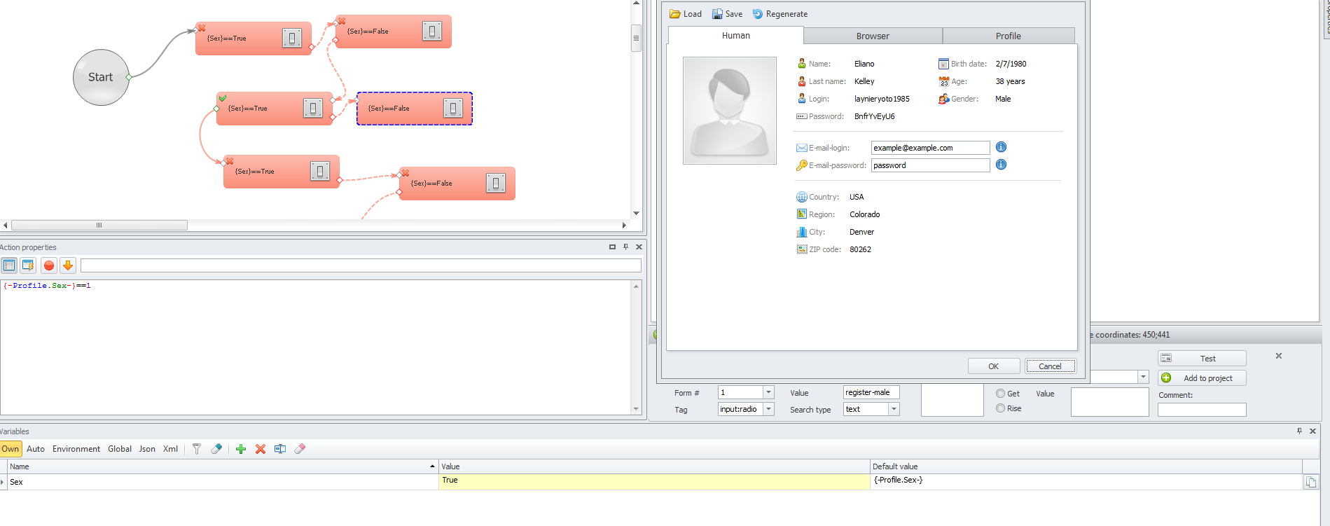

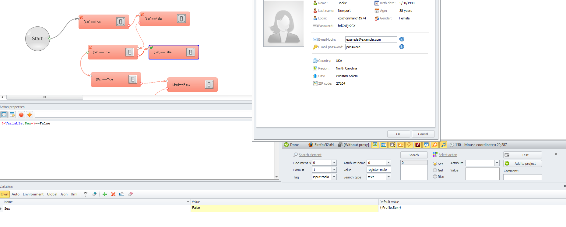

Found a bug I think
using If to test
{-Profile.Sex-}==True
{-Profile.Sex-}==False
doesn't work. it will fail
If I set a new variable, {-Variable.Sex-} and set its default value to {-Profile.Sex-}, it will take the if as true if gender is male
and if as false if gender is female, but the default {-Profile.Sex-} will fail in both cases.
check pics

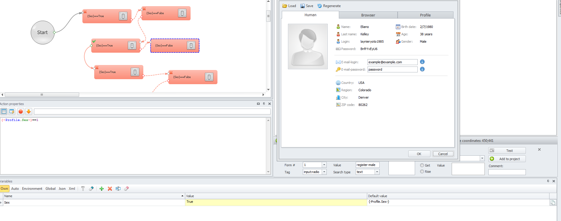

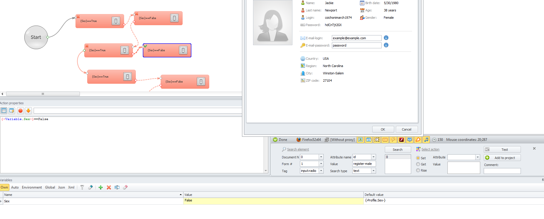

Found a bug I think
using If to test
check pics
If You check string then use quotes
although no need quotes for numbers...
