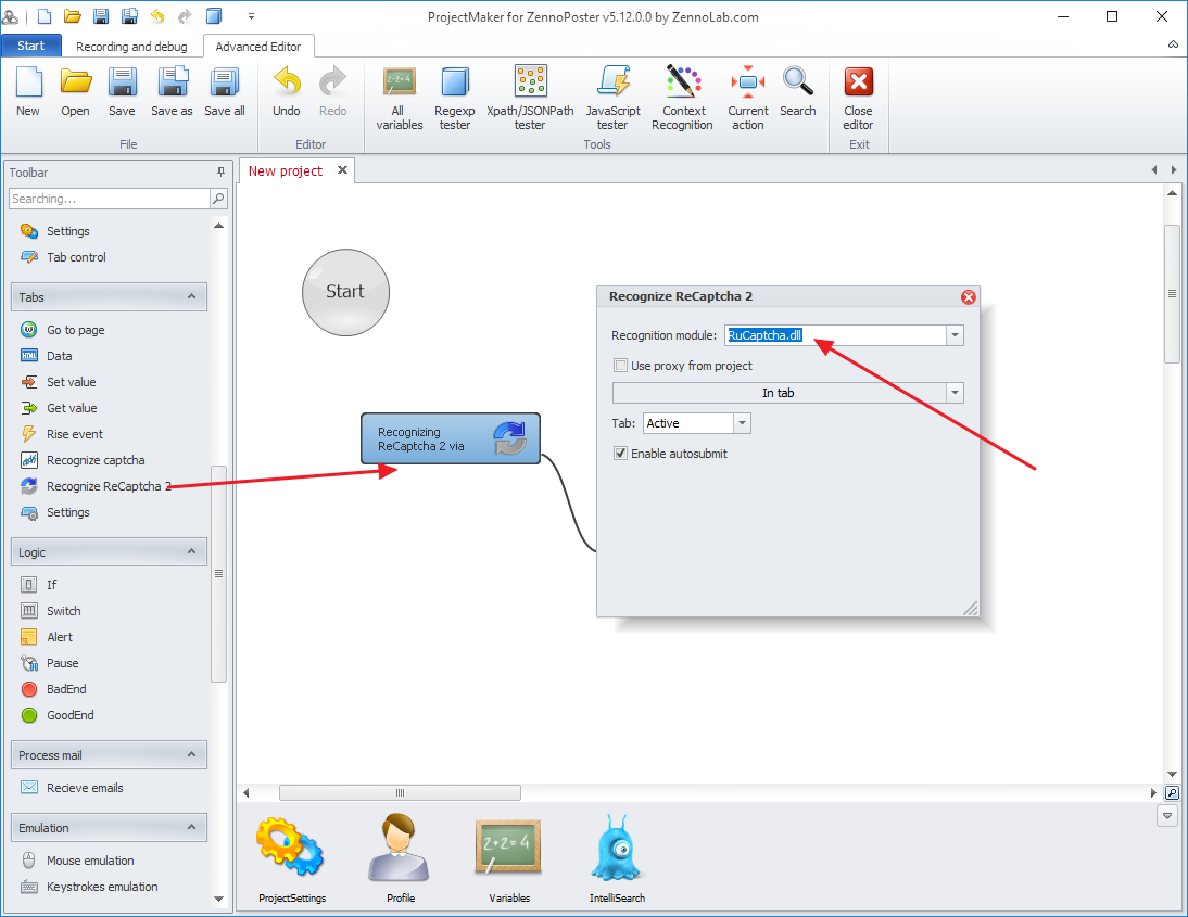

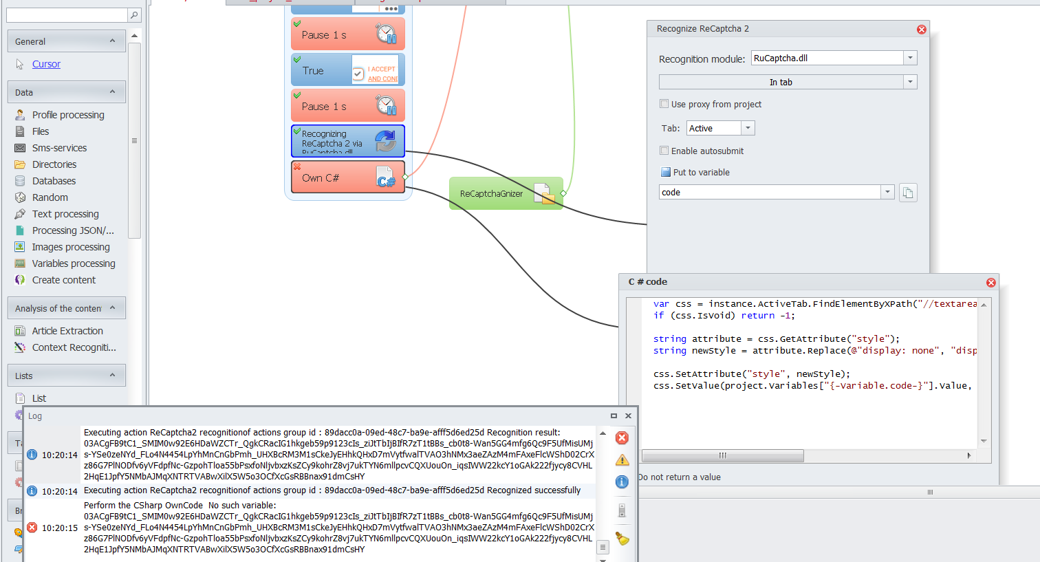

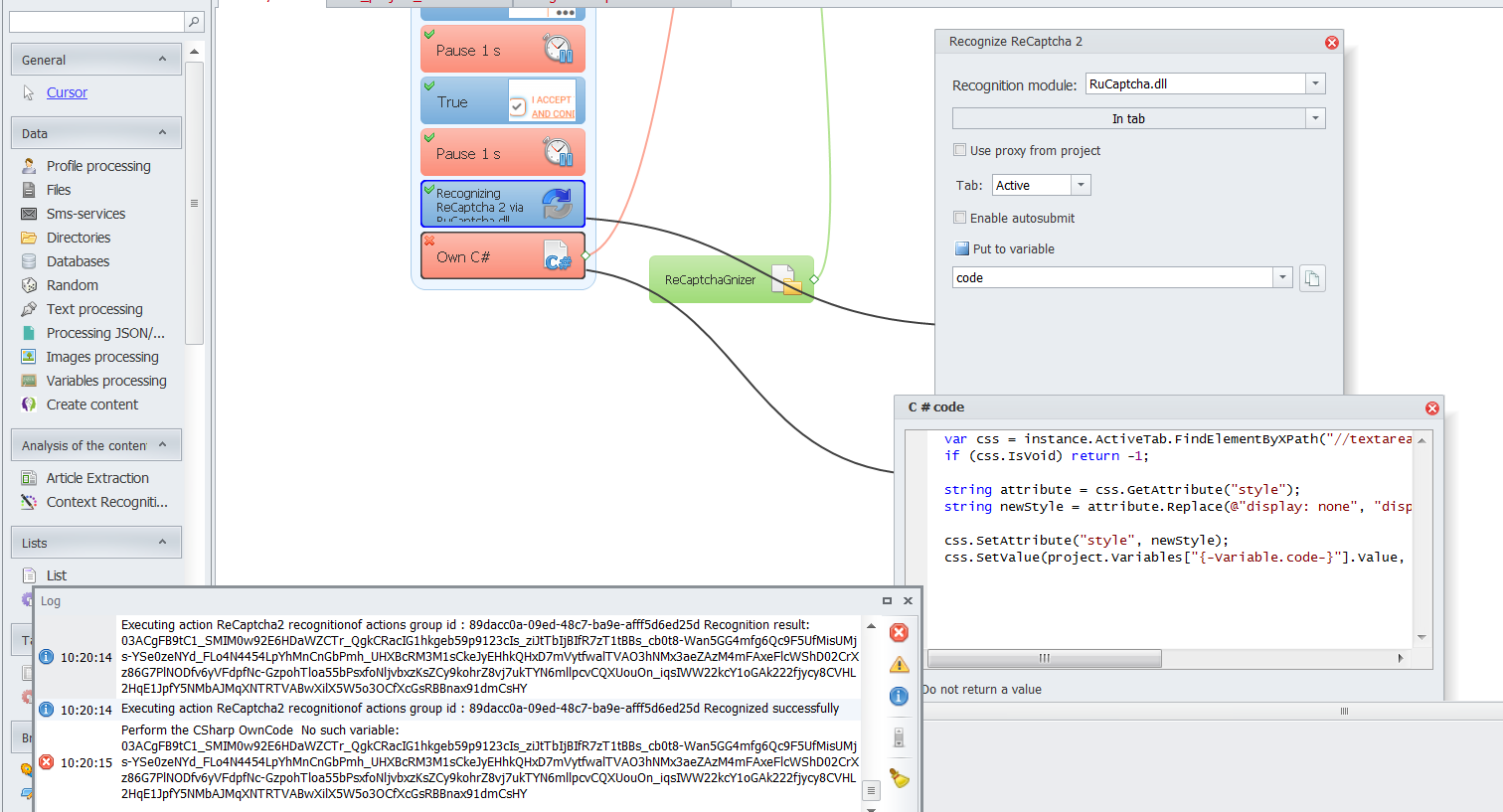

please help me,
This sniptcode could deal with invisible recaptcha ? I have try this. but I got error.
I also have try with Lord_Alfred code but I have error

noname007
19.04.2018
42
noname007
19.04.2018
42
The problem has solved. Thanks.
