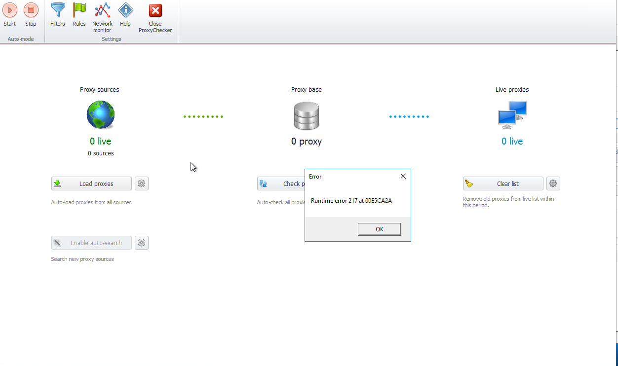

Instances hang in the middle of project (ZP Pro 7.0.6.1 (201910010150)
Just installed the new V7 of ZennoPoster and added some of my projects created with with V5. I used the Windows (2008 R2) scheduler to start the projects at a give time intervall (every 25-45 minutes). Sometimes it works without problems and from time to time the instance stops working (hangs and keeps open) for an infinite time. The windows scheduler adds more nr. of attempts to the projects but nothing more happens than the execution count of the projects are increased.
I restarted the server several times, updated to the latest .NET 4.8 framework and opened the affected projects in PM V7 and re-saved it. Also added the complete Zennolab folder to the AVs exclusion list. But that didn't solve the problem. All projects use the FF x64 engine.
Send you the error report via support ticket and hope you can get this solved soon as the new interface looks quite nifty.

It seems that the projects stick at the same point (action "Project in project) every time! I now reconfigured the nested project and converted it to a Zenno-plugin and added it to the affected main-projects. But now it seems to stick at the point where it calls the plugin. :bc:
22 789
6 021
This is the bug caused by third-party software.
To avoid this we made this option in version 5.32.
+ An alternative proxy checking method was added. ProxyChecker now contains a "Use the .NET process for proxy checking" setting. The alternative method helps to avoid error 217 for affected systems and lowers the resource consumption when checking proxies.
