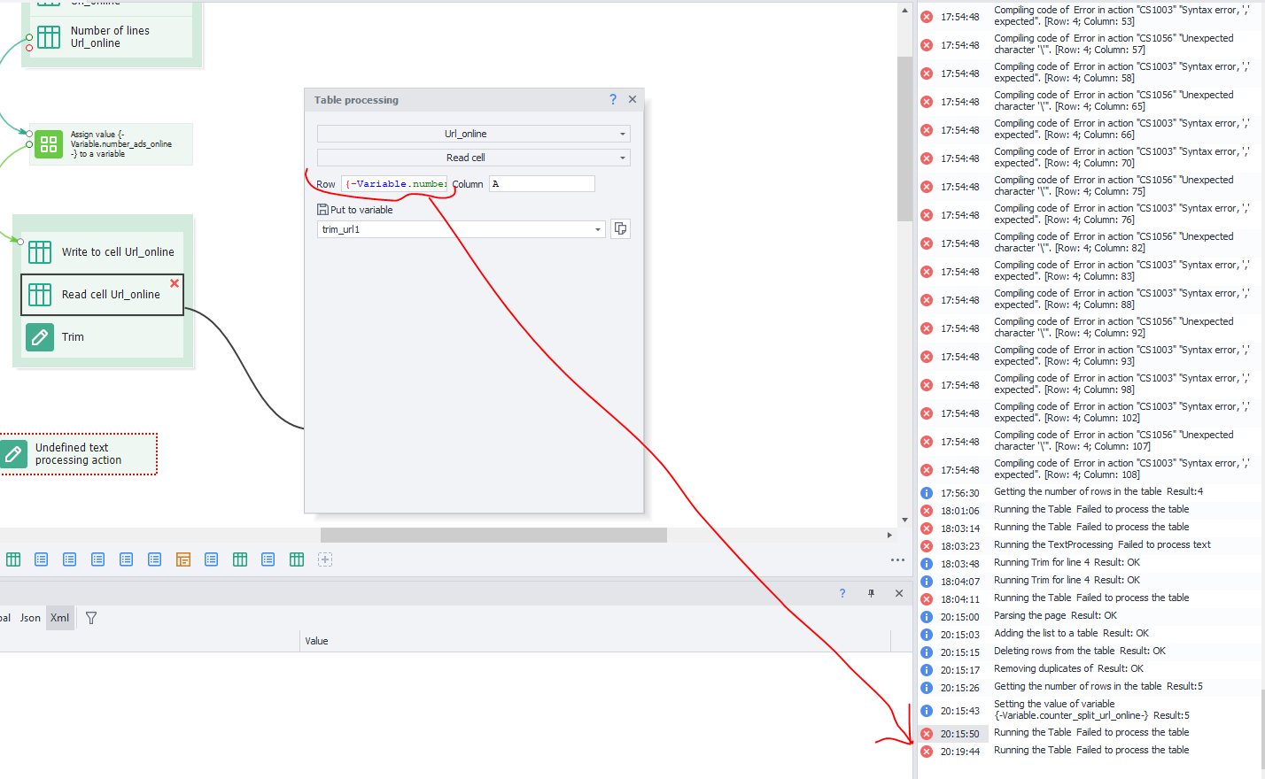

On table, i got an error while reading a cell with variable as row (or column).

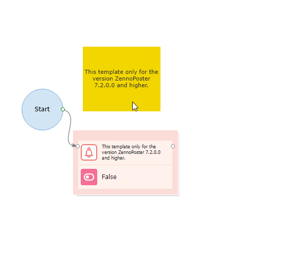

I have tested the newest version I found that I do not want to use it, for now, so I have downgraded to a version what worked fine for me, but now I face a problem where I can not open my template in this downgraded version, even I have not used any newly added features, but I just have saved in it in the new version, and since there are not possible to set the lowest version than 7.2 it seems I'm stuck with buggy version?

You can save template as xmlz in version 7.2., then open in version 5 and delete protection block there. Then import xmlz template back to required zennoposter 7 version.

Have to have 3 version installed for this simple thing, but thanks anyway.
The problem caused by updated C# version. If you use C# code in your template, 7.2.0.0 is minimal version for template encryption when saving it.
I think we will deal with it in next build.

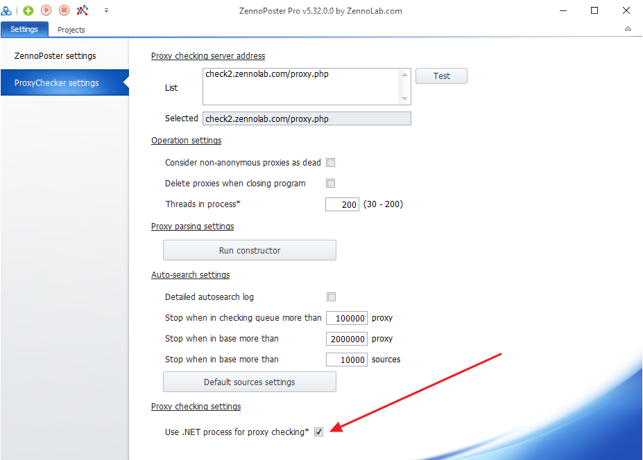

Looks like the problem with CheckingProcessor process and the soft we don't like on our forum.
Is this option enabled in program settings?

Are you sure there was proper value in the variable? int type, existing row
Yes i think so. I use table processing>Get the number of line and put value into variable (v1). After that, i read a cell in a table by using table processing>Read Cell and i used variable v1 as row or column, then i got the error "Running the Table Failed to process the table". I stuck on it please help.
Could not reproduce it. I still advising you to check variable value and make sure it's proper at the moment of execution.

I re check, same error. See attach, the last step in my template never work , It consists on reading a cell on table with variable as row or column. error:
Running the Table Sequence contains no matching element

Also, lists and tables are empty in your example. There are no parsing results, no data and nothing to read from cell in a table.

yes, i made an error, there is no parsing result. Look on this more simple template, i get the same error Running the Table Failed to process the table" , can you try it please. It will help me , i stopped all my work due to this error.
No, I do not have this enabled. I do nothing with a proxy checker.

Lines numeration starts from zero in a table. So, the last row index = number of lines -1
Please check attached template.

Thanks , it works fine :-)
