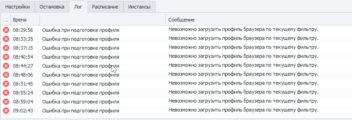

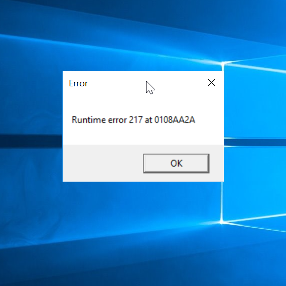

What's this? Just something went wrong. No updated I just logged on the server and seen this was happening in the middle of the day.

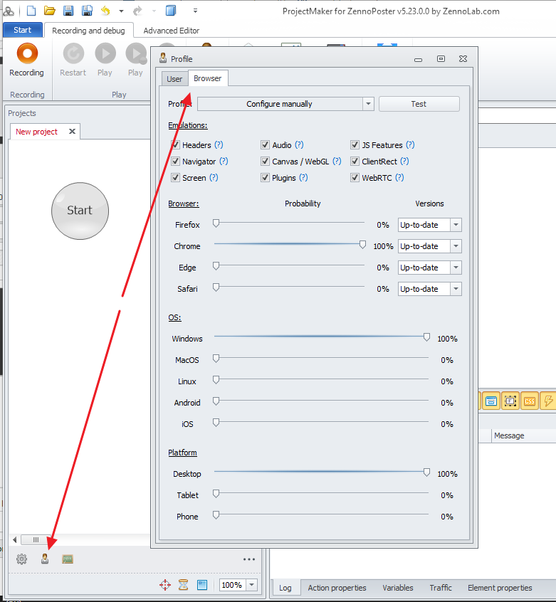

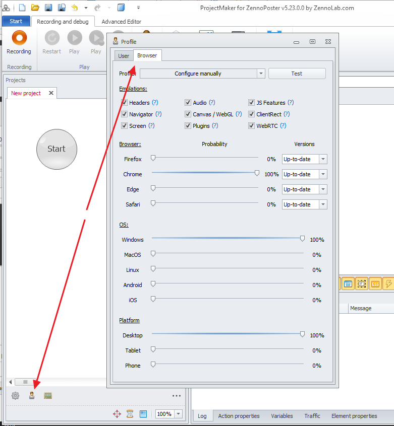

This means something went wrong creating or loading profiles in your template. I would recommend you to change profiles emulation settings in your project to something more common.
this template does not work with any profile files at all if that's what You mean.
And it has to Generate by default in this tab, so nothing really from my side.
As I told you it happened for 2-3 hours and then started to work again.
22 242
5 848
Yes, but template is with browser right? zenno generates new browser profile when starting each thread.

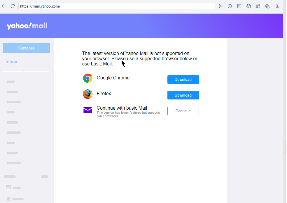

Chrome engine needs some update. Profile = Generate by Default
UA: Mozilla/5.0 (Windows NT 6.1; Win64; x64) AppleWebKit/537.36 (KHTML, like Gecko) Chrome/85.0.4183.102 YaBrowser/20.9.3.126 Yowser/2.5 Safari/537.36

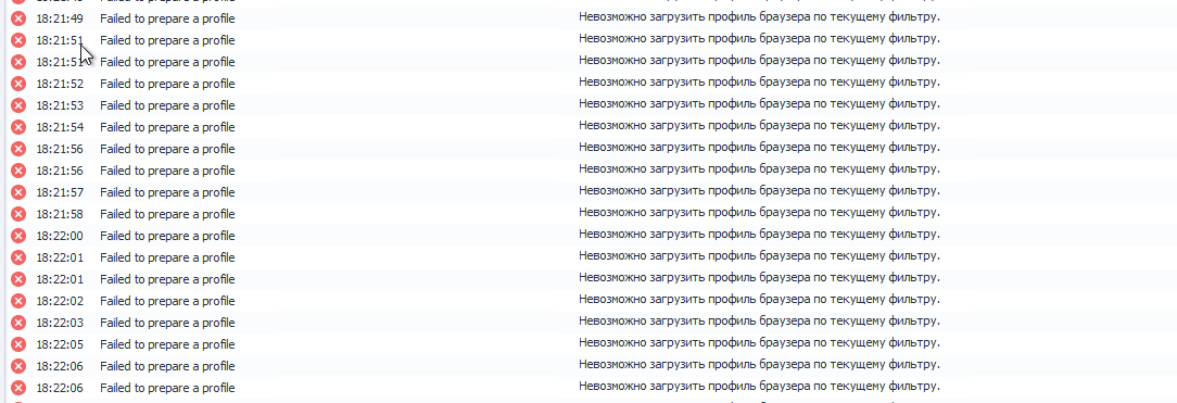

VladZen It starts to happen very often. In the last 24 hours, bots stopped working for 4-5 hours. when this will be fixed?
Thanks

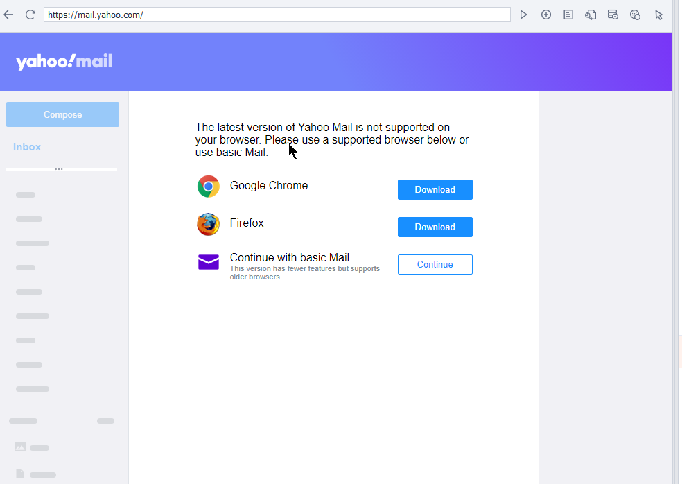

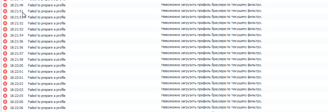

Hi, it seems not related to the Firefox engine at all. This is a template. I made it yesterday and as You can see it is not working. Can we get this fixed, please?
73928
UPDATE: It's happening even with one of the templates where the browser is not enabled at all.
Latest version man. 7321
22 242
5 848
Try changing all entries userarea.zennolab.com to userarea.zenno.io in ZennoPoster.exe.config and ProjectMaker.exe.config files.in Progs folder in program directory.
If it won't help, please send us the example template which reproduces the error.

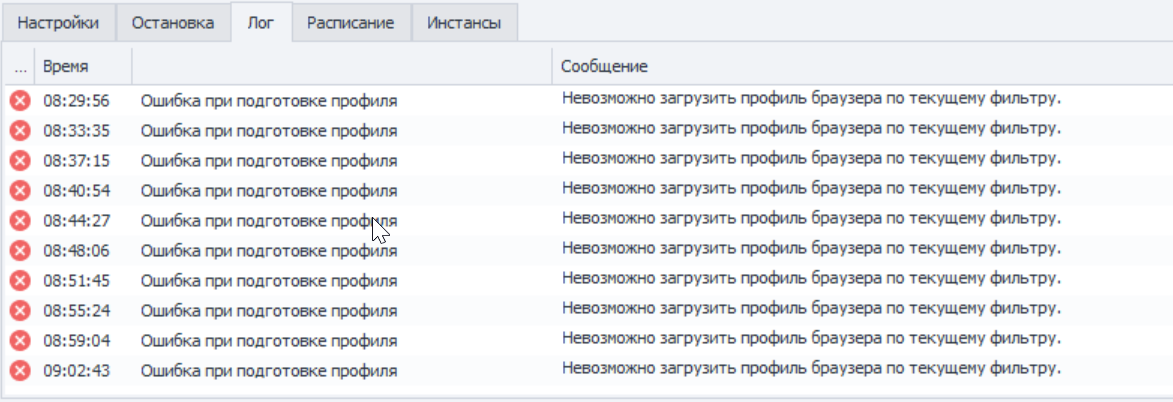

I will try this new suggestion, but You can be sure this is not template-related at all. There I made a test. And created an empty template. Just now woke up and this and my other two templates, one with chrome browser another with only requests was down again. Problems started at around 03:00 at night and 08:00 when I woke up it still did not work. I really need some tasks to get done, man. It is urgent.
