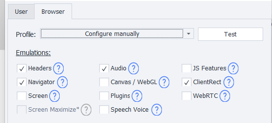

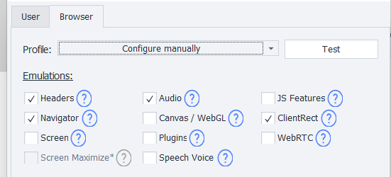

Tried these settings and project ran fine. Can you show full screenshot of this window? I think that the problem may be because of other settings (also you can press "Test" button to see if you choose proper settings).

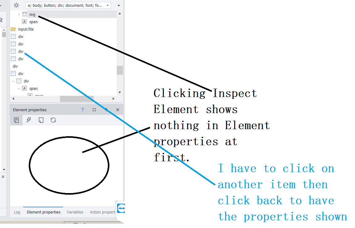

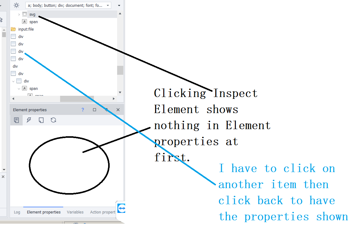

You can use "Refresh" button to update window contentElement properties
Is there any error message in Log?When I click start, it stuck at
I can click on another element and click back to have the properties shown. The bug is that it doesn't show at the beginning. It's not an important bug.You can use "Refresh" button to update window content
When using Phone, an error message is shown in the logIs there any error message in Log?
What platrom did you set? Is it "phone"?(at the bottom of the settings window).
OK, I will report this.I can click on another element and click back to have the properties shown. The bug is that it doesn't show at the beginning. It's not an important bug.
This error means that you set wrong settings for profile generating.When using Phone, an error message is shown in the log

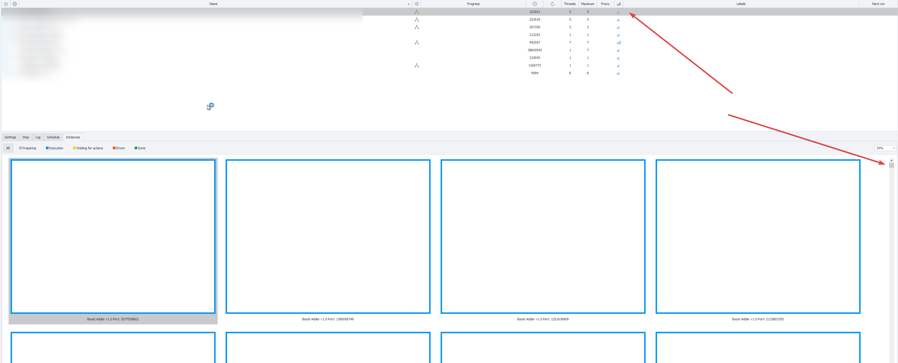

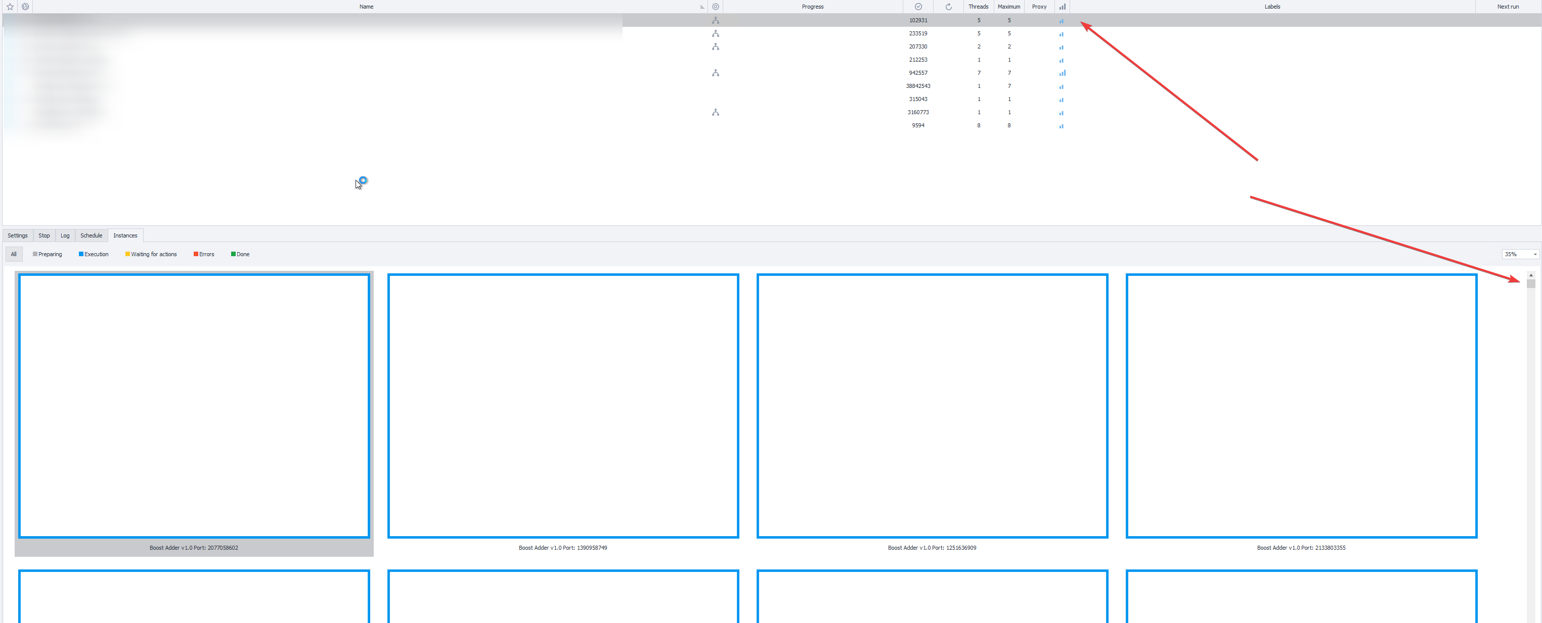

Not sure what is actually the problem.Посмотреть вложение 83201
What is happening there? Looks like all instances are in separate instance view. + not all there looks like 100 instances started but I got only like 20 running. + I do not see what is happening
