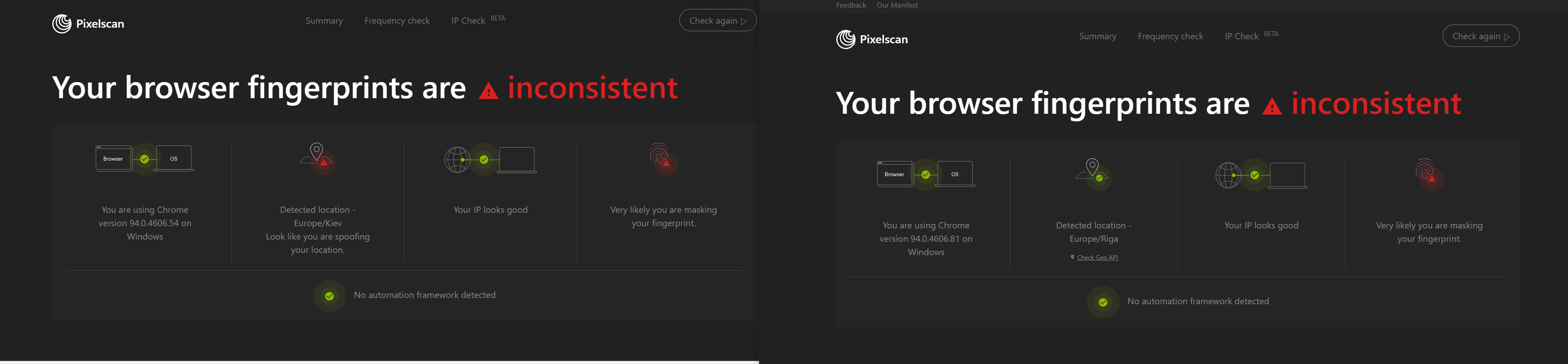

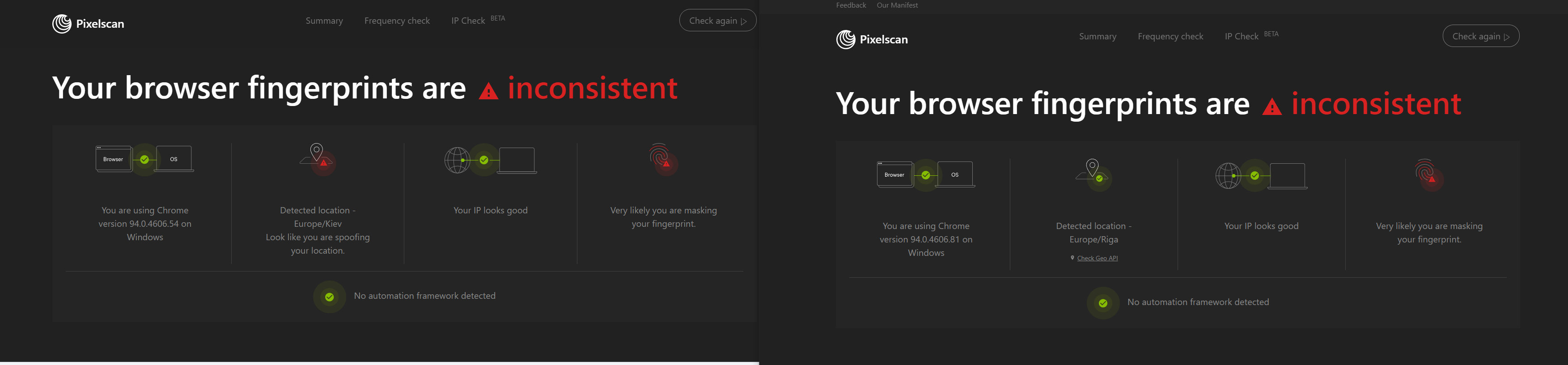

please give more details.I noticed 2 bugs but I'm not sure if they are exclusive to 7.5 as I did not test it with the old version. When using http://pixelscan.net/ I noticed that the Timezone & Fingerprint Spoofing Is always detected. I have timezone spoofing enabled in "set proxy" but it still keeps using the wrong timezone.

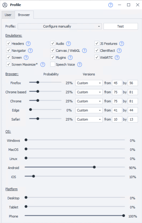

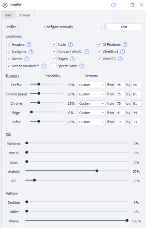

And what are browser profile settings?
Inconsistent fingerprint is known issue. We will fix it in later versions when update canvas emulation.

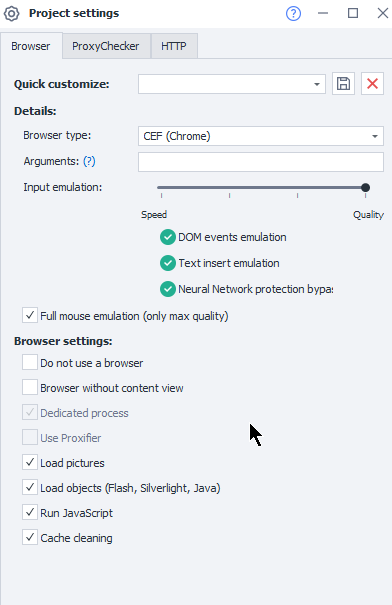

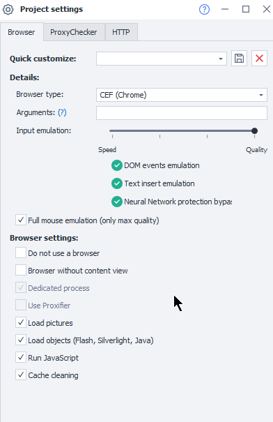

Need to know what browser engine is used (CEF Chrome I guess), emulation speed in settings and if the problem faced on some certain website or different sites.Fields losing focus or something in newest version 7.5. Maybe thats known issue ?
I have noticed with my current project that for example password does not get entered fully. It just cuts off some part of password, therefore login fails. What information Do You need @VladZen ???
It does not happen always, but it happens for sure, because I just got report from another customer with same problem.
It is definitely not related to some particular PC. And I have tried with C# and with default actions and same gave this problem.
Yes CEF.Need to know what browser engine is used (CEF Chrome I guess), emulation speed in settings and if the problem faced on some certain website or different sites.
Ok, we will test the problem.Yes CEF.

Settings I posted above was changed. With disabling mouse move emulations and I guess there were same problems, but I can not be sure, as this is not something I can reproduce easy. All I can see is I get errors with wrong username/password + I can see sometimes that password is entered with 2 characters in zenno instance view for example.

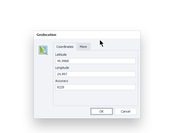

What is wrong with this?

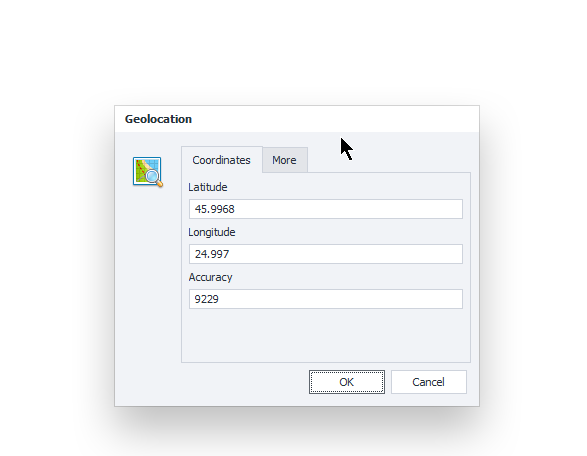

I have in proxy method where I set emulateGEO = true. BUT I see this window with asking me to confirm GEO data pops out at random places.
Just now it pop out AFTER I have finished to debug whole template. Is not that wrong somehow ?
This pop up comes out at random times, while debugging. nothing to do with time when browser opens.It does not depend on template.
When a website opened in PM browser asks for geo, then this popup appears.
geo emulation for proxy does not block this popup. It emulates coordinates which you have in this window.This pop up comes out at random times, while debugging. nothing to do with time when browser opens.
Like I told I was already done for approx 1 minute to debug template what took around 5 minutes, with working browser and working things in browser and ONLY then this pop up appears.
Moreover setting proxy WITH emulate GEO is at the very beginning of template. It should not pup out at all.
But this pop up blocks template execution, please look I have sent demonstration in Instance freeze support ticket.geo emulation for proxy does not block this popup. It emulates coordinates which you have in this window.

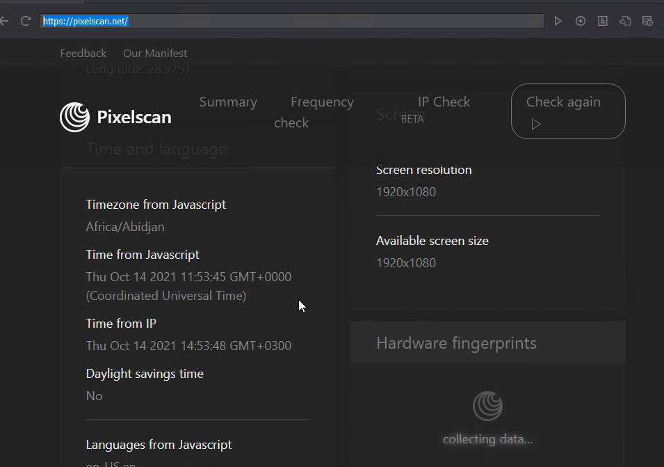

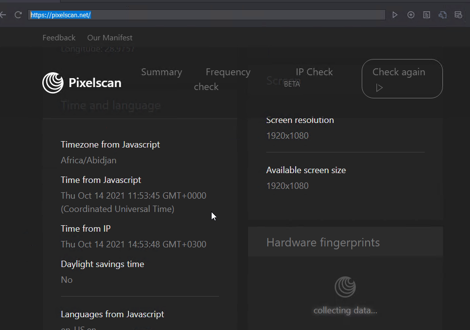

What pixelscan shows in usual browser on customer's pc?My customer constantly gets this: Посмотреть вложение 84241
Africa etc. But he is from turkey and he has no ides why this happens.
I have also checked all PC regional settings, there is nothing about Africa, nor he is using any proxies and such.
Shows that same Africa.What pixelscan shows in usual browser on customer's pc?
Please make sure, there is latest geo base on the computer:+ why it still shows different? Was not there fix for pixelscan ?
Left side is PM and right side is my PC chrome:
That's how pixelscan detects customer's IP. no bug in zenno.Shows that same Africa.
