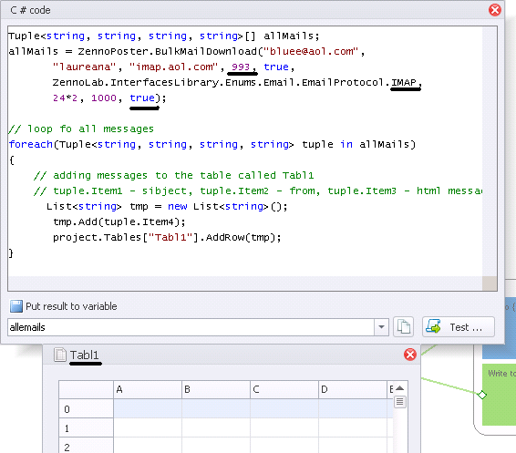

You can use C# BulkMailDownload function in the latest build 4.3.5.0..
using this c# code to download all messages in one mail:-
Tuple<string, string, string, string>[] allMails;
allMails = ZennoPoster.BulkMailDownload("username@gmail.com",
       "password", "imap.googlemail.com", 993, true,
       ZennoLab.InterfacesLibrary.Enums.Email.EmailProtocol.POP3,
       24*100, 1000, false);
// loop fo all messages
foreach(Tuple<string, string, string, string> tuple in allMails)
    // adding messages to the table called Tabl1
    // tuple.Item1 - sibject, tuple.Item2 - from, tuple.Item3 - html message, tuple.Item4 - text message
       List<string> tmp = new List<string>();
       tmp.Add(tuple.Item4);//body of the text message
       project.Tables["Tabl1"].AddRow(tmp);
You can save downloaded mails to table and save it to a text file.
After Parse the activation links from the messages in the text file using RegExp and save the parsed activation links to text file.
Finally take the Activation Links from Textfile One By One place in Go to page function to Activate it....:-):-):-):-)

@purush84 or anybody else how want to share: can you provide some simple example where you will show us, how to download all email and save to txt with this C# code?
This bulk email processing will be huge help for all of us.
@drvosjeca suggest something about recording the actions as we usually log in the mail client, but it's not working for gmail.
Please share your experience about this.
Thanks!
01.02.2011
99
15
Your having problems because the above c# example & wiki example don't work because of a simple typo in the foreach loop.
In example above, change "Tabl1" to "Table1" or the name of the table your using (aka Table2, Table3).
project.Tables["Table1"].AddRow(tmp);
- Copy/paste into "c# code" action
- add "Table" action
- add "Table processing" action, link to c# action, & set processing action to "save to file" for relevant Table (use .txt)

No typo if you name your table Tabl1
Реакции: mikakojonkowski
01.02.2011
99
15
Framework autogens a commonsense english dictionary name, thats explicit to context & Class, with a sequence of appended integers to avoid namespace collisions (aka good commonsense time-savers). Why would you go out of your way & fuck with something that works out of the box & deliberately introduce a misspell in two parts of your code? 0_o
Also bear in mind there is no error/exception handling specific to the c# loop, so have fun in 6-12months time debugging a template change with a generic error msg & a one char difference from system autogen.

Easy guys, i was simply asking if someone could share example where we can see how it works, because not everybody have exeprience with c# and for now bulk email processing can be done in this way only. So if someone wants to help THANKS. We are looking for help here not fight.
bigcajones
09.02.2011
1 228
685
Посмотреть вложение allEmails.xmlz
Here's a free sample of it for you. The email and wordpress site will cost you dearly though. :p
And just to show how it can be done, the table is named Tabl1 and lo and behold it still works! Imagine that.
Реакции: www и priestxandar
