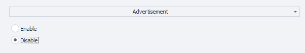

blacky
08.02.2022
Or you can use this in browser setting :
