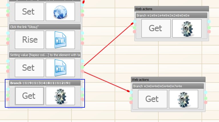

In the template you uploaded, the Pause macro is completely skipped. The way the steps are connected it never gets to the pause macro.
Looking at the picture you posted though, I see you tried moving the connections so the pause macro does not get skipped. The problem there is that the template chooses which path to follow based on whether the pause macro was successfully executed and not whether the step before it was successful or not, which I assume what you need the two paths to be based on.

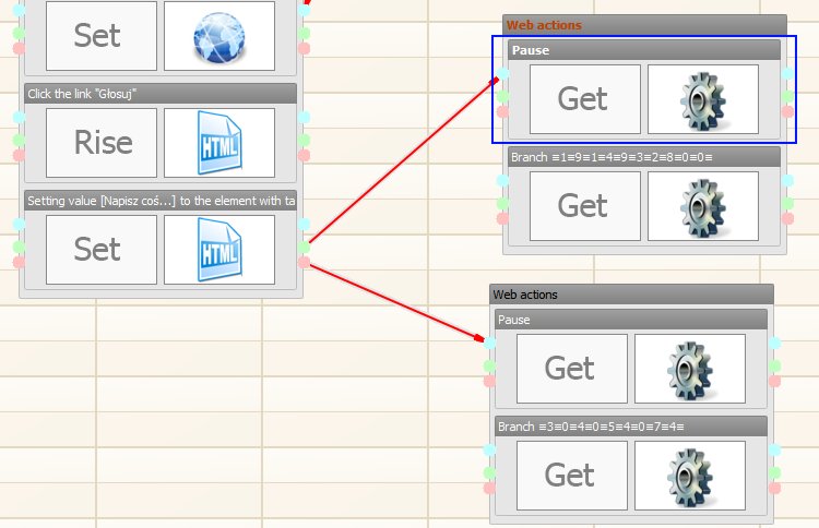

Try this out and see if this fixes it (I didn't actually run through the rest of the template, but if it gets to this point I don't see why a pause macro shouldn't work). What I did was delete the pause macro where you had it and created two pause macros in the separate branches. Here's the .xml file for you to run and see if it works:
thx a lot! now is working perfect :D
