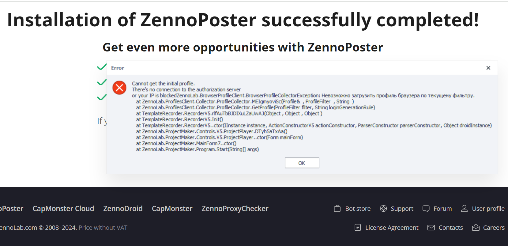

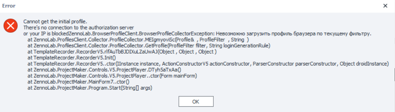

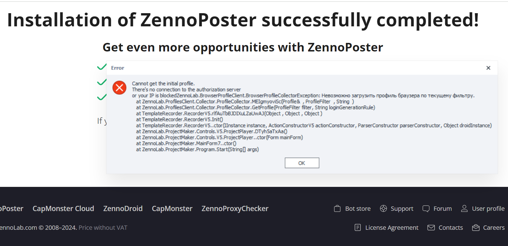

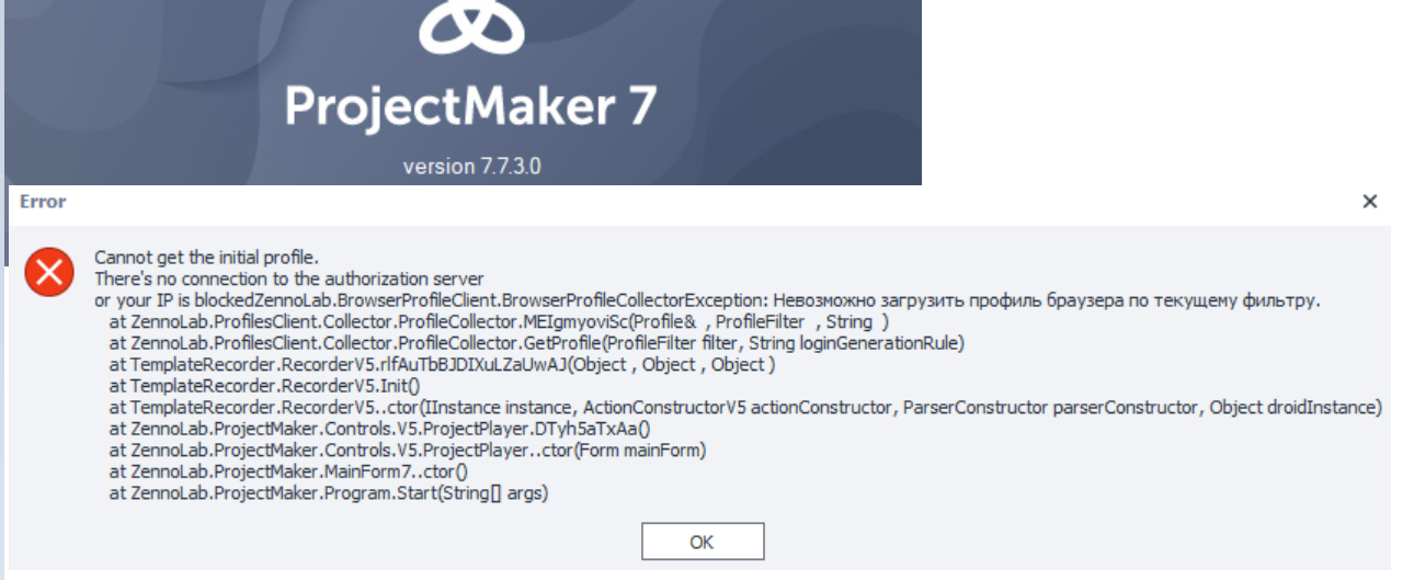

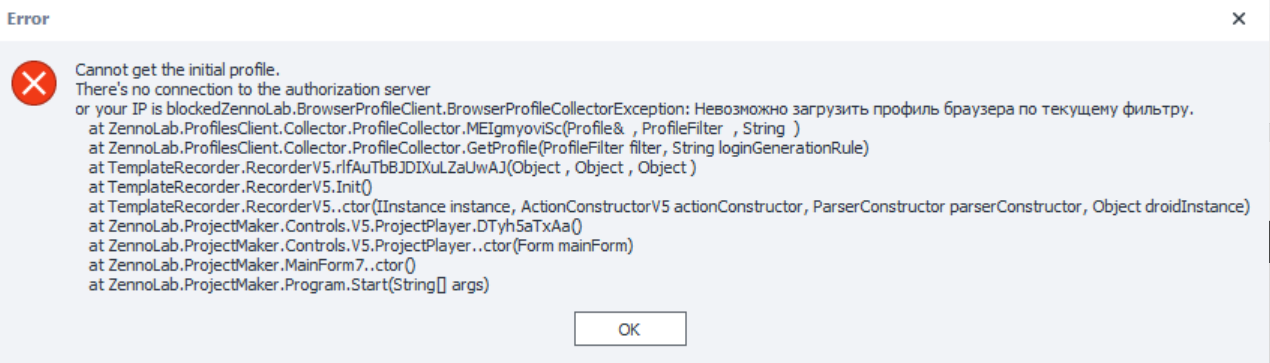

Since last week I am not able to launch PM, with the following error.
120535
I tried multiple versions (7.7.3 and 7.5), but neither of them worked.
Please let me know how to solve the problem.

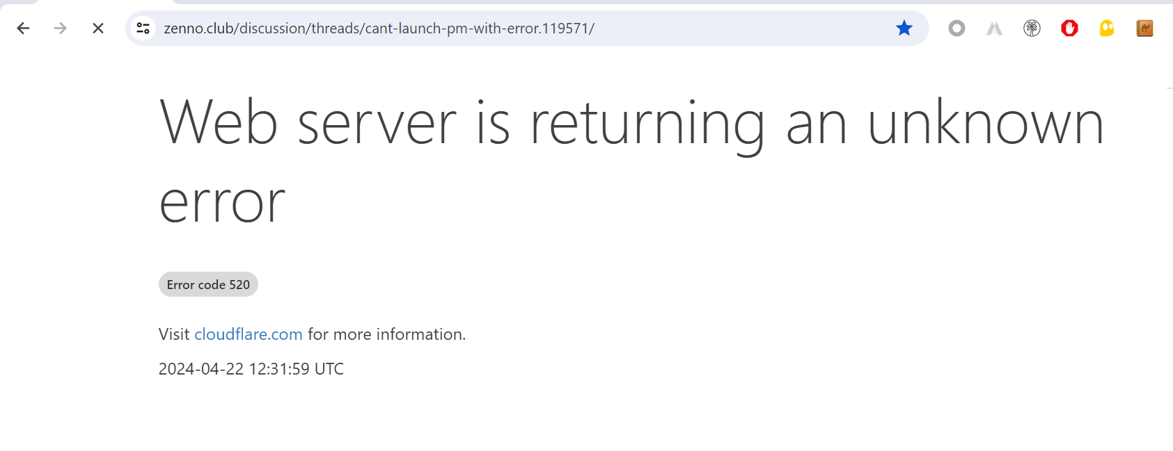

I don't know if it is related. Sometimes I got this error when visiting this forum.
120659

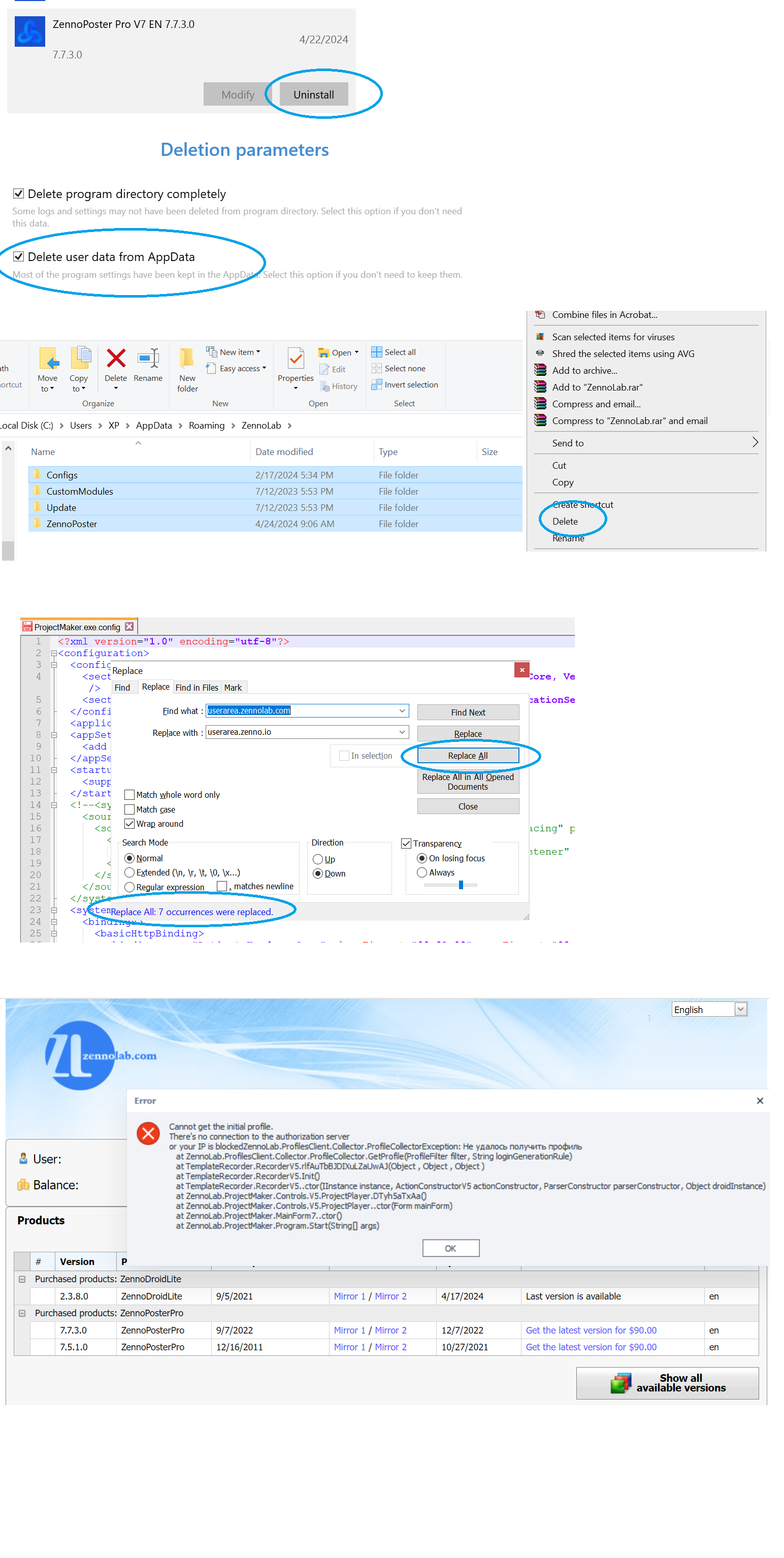

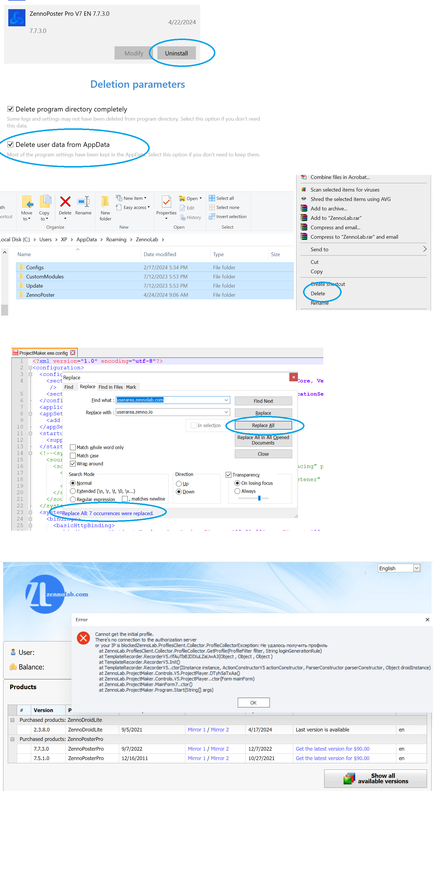

Yes. And for clarity I did all these all over again.
1. Uninstalled ZP, by selecting "also delete Appdata"
2. Manually deleted everything in Appdata folder
3. Install ZP
4. Replaced all userarea.zennolab.com to userarea.zenno.io in ProjectMaker.exe.config
Still the same error. And yes, I am able to log into userarea.zennolab.com, as shown in screenshot as well.
I have multiple licenses of ZP pro, and a ZD as well. Could it be the reason for conflicts?
Again, The new report.zip was sent to [email protected].

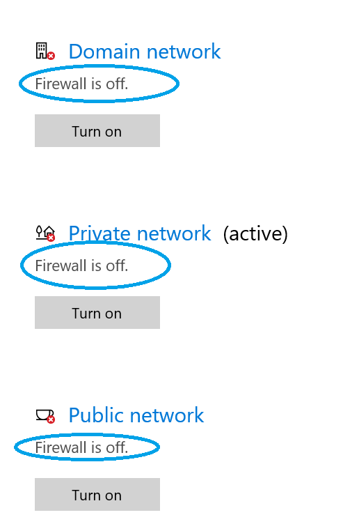

There is probably something wrong with internect connecton to our service from your PC, try disabling antivirus/firewall and other protection programs. And also unload the programs which consume large network traffic.
Cyrix
16.12.2011
393

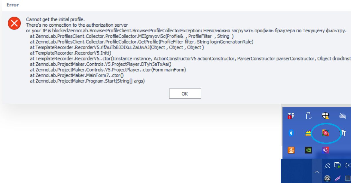

Antivirus is disabled, and I am using 1 Gb internet with no other program consuming traffic when the error occurs.
This is my main PC and I am using it on all websites consistently without issues. Speedtest is flawless.
PM had been working well until last week, but now I can't do anything.
Update: I was able to open PM once after about twenty tries (took hours). It seems like there is a very difficult connection to the server.
Do you have another address of the authentication server that I can connect to? Or could there possibly be issues with a new configuration of your server/host?
I really need this to work. Thank you.

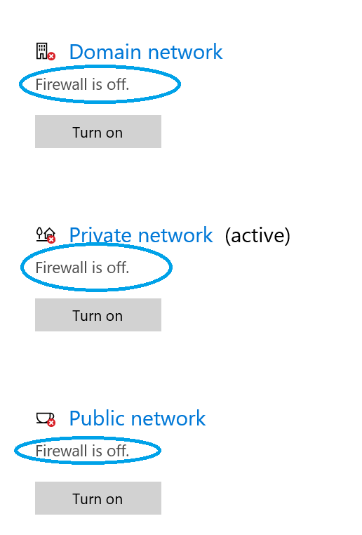

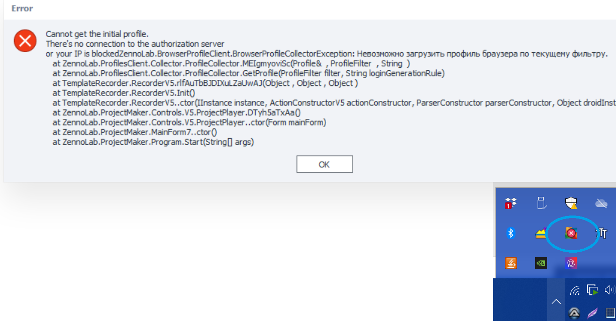

you may also try these servers:
userarea-us.zennolab.com
userarea-hk.zennolab.com

userarea-hk.zennolab.com works. Thanks.
