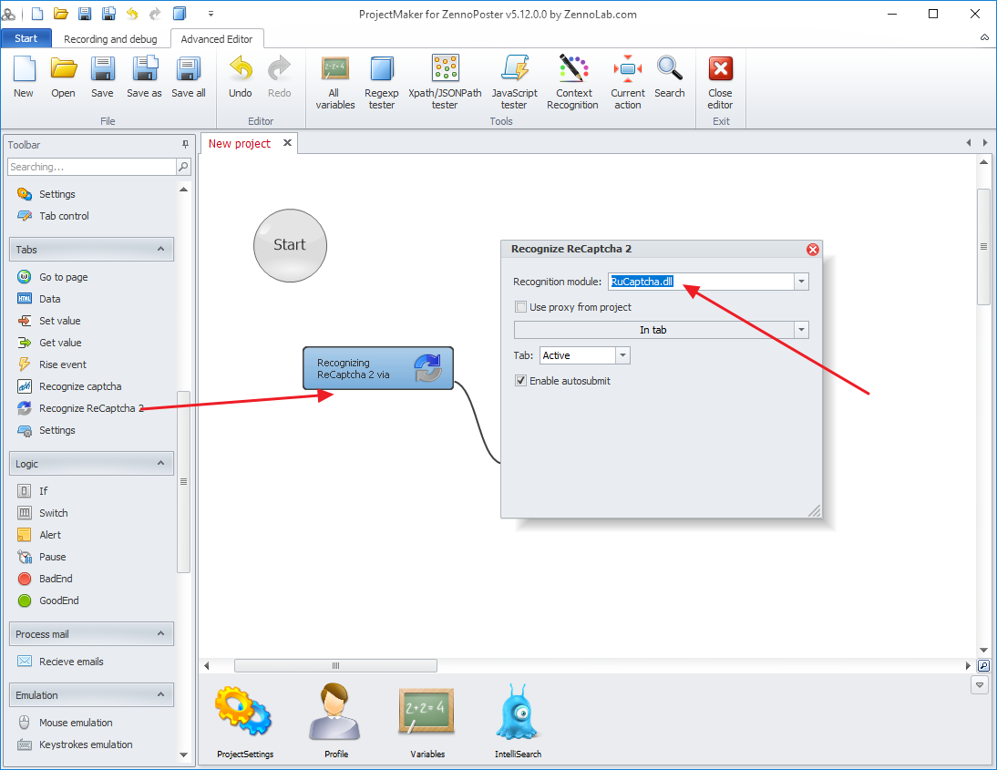

You should configure the block ReCognize ReCaptcha2 as shown on screenshot.
Also, you should insert random api key for RuCaptcha in project maker settings->Captcha section.
and enable RuCaptcha emulation in CapMonster 2 program settings>emulation.
yes i add the api for rucaptcha/deathcaptha/antigate. and my setting is same as you.
