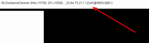

Hi, is anyone here who builds backlinks with ASP?
I working with several SAP and CM, but can't solve the Captcha. (2captcha coats so expansive!)
I checked that SAP and CM are connected, but only the error log 'Time out for loading element has been exceeded' appears.
Pls check the video and share your idea.
Need Help.
Thank you. :-)

It seems that SAP sends proxy in the format that CM2 can not recognize.
84131
Correct format for CM2 - protocol://login:password@ip:port or protocol://ip:port, if you don't specify the protocol then http is used by default.
Try to add proxies directly to CM2, enable option "Use proxies from the CapMonster list, even if another proxy is specified in the request", so CM2 will ignore proxy from request and will use one from internal list.

Dear Nicanil.
Thanks for your advice! It works!
