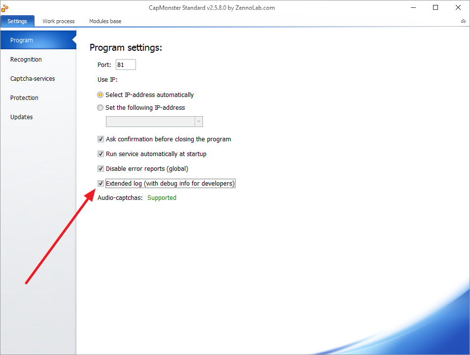

Please enable detailed log in program settings, reproduce the problem and run Diagnostic.
Send me created report.zip file.
