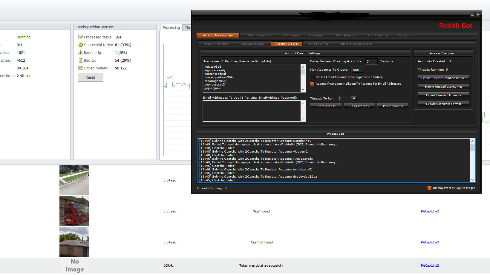

I'm using capmonster lite version with my reddit bot. Capmonster solving recaptcha v2, token was obtaining successfully. The problem is token is not correct and my bot gives captcha failed error. I tried my bot with 2captcha api. They are working fine. Could you try capmonster with Reddit?

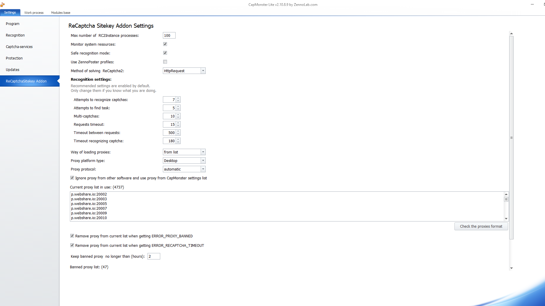

What method of solving do you select in CapMonster settings? And what type of proxies do you select?
Please attach screenshot of recaptcha addon settings in CapMonster.

I'm trying to solve captchas with 2captcha module. Tried both desktop and mobile. Nothing changed.

Always say there on forum - you should select Chrome method of solving for ReCaptcha2, not httprequest.
