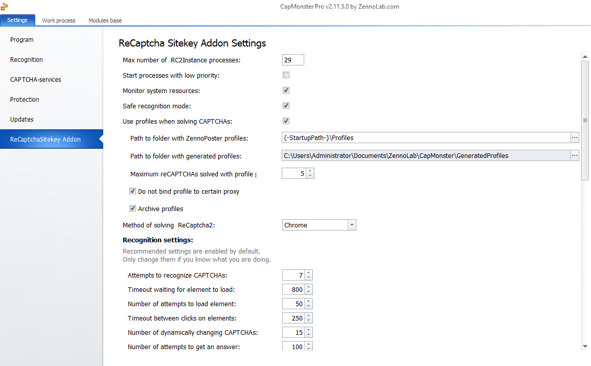

It still gives me only 0.1 score tokens.
I am solving many recaptcha v2 first to get trusted profiles.
Then I solve recaptcha v3 but it still not good.
I use with residential proxies.
My settings:
This version still gives low score, but provides higher success to bypass recaptcha3.
You can compare solving time of recaptcha3, it is increased.
So, advise you to try bypassing rc3 with it.

27.09.2019
15
My settings:
Do you use profiles, gain cookies?
You can see my settings on this. I have used profiles.
So many recaptcha v2 solved before i request for a recaptcha v3.
But always responsing 0.1 score :(
