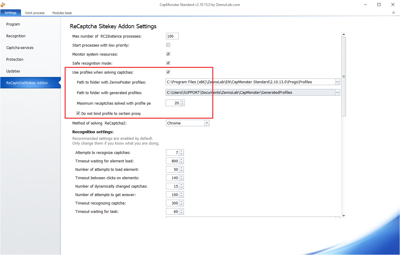

Try using profiles option for solving recaptcha3.
It will increase success rate.
