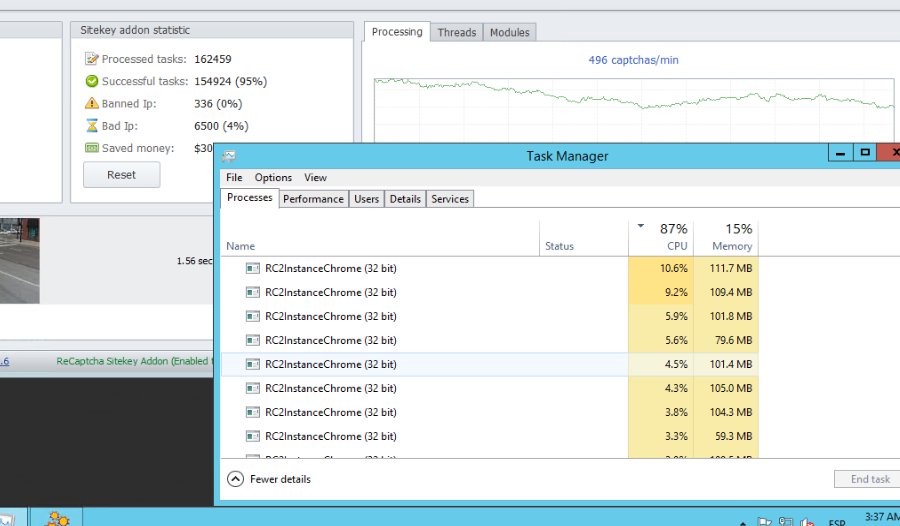

C carlitos9027 Новичок Регистрация 23.10.2018 Сообщения 4 Благодарностей 0 Баллы 1 31.08.2019 #1 My capmoster is consuming all the cpu of my pc with 32 ram and 8 processors any solution?
VladZen Administrator Команда форума Регистрация 05.11.2014 Сообщения 22 233 Благодарностей 5 846 Баллы 113 03.09.2019 #2 That's quite normal you are solving about 500 captchas per minute. You may check Monitor system resources and reduce number of RC2 instances to reduce CPU usage.

J Jeremyrem Новичок Регистрация 27.06.2019 Сообщения 16 Благодарностей 1 Баллы 3 28.09.2019 #3 carlitos9027 сказал(а): My capmoster is consuming all the cpu of my pc with 32 ram and 8 processors any solution? Посмотреть вложение 41399 Нажмите, чтобы раскрыть... that sounds about right. I have dual X5660's and can do about 1200-1300 a minute using firefox so if you need more might be time to upgrade the CPU. You can also try using HTTPRequest as it uses ALOT less cpu/ram, but I think the success rate is a little lower (not 100% sure)
