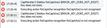

@VladZen I have a problem with Capmonster.
I got the sitekey addon yesterday for Capmonster but it keeps failing when I try to send a ReCapthca2 to Capmonster with this error:
I entered the correct sitekey for that website in the Recaptcha settings block in the project. (The sitekey is correct, it works when sending to RuCaptcha.)
It's the same error on every website.
How to fix it?
How to fix it?
This is not sitekey error. You have not specified user key which is in Protection settings in CapMonster.
